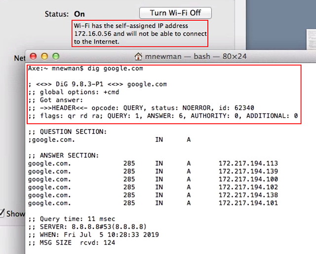

The Network control panel tells me that this machine has a self assigned IP address and will not be able to connect to the Internet. However, I'm logged on to it via Chrome Remote Desktop. So, obviously it can connect to the Internet. It is WiFi only; no Ethernet cable. And, there's this:

Sorry, for not making myself clearer. The IP address 172.16.0.56 is a private IP address that was assigned by the DHCP server on my AirPort Extreme. I've never seen such an address called a "self-assigned IP address". And, the language "will not be able to connect to the Internet" is somewhat baffling since the machine is obviously connected to the Internet.
I am able to connect to the machine, which is behind a double NAT, via a reverse SSH tunnel:
Code:
MrMuscle:~ mnewman$ ssh -p [nnnnn] mnewman@localhost
Last login: Mon Jul  8 05:51:02 2019 from 172.16.0.56
So, why does the OS say that this is a self-assigned IP address when it was assigned by a DHCP server and why does the OS say that the machine will not be able to connect to the Internet?
Try removing then recreating the wifi interface.
I tried turning WiFi off and on and that changed nothing.
My wife's MBA is connected to the same network with the IP address of 172.16.0.55. All it says is that WiFi is connected. Nothing about a self-assigned IP address or being unable to connect to the Internet.
I reset the SMC on my MBA, but the odd message is still there.
That message should only appear if you have an APIPA address. Maybe your initial DHCP query failed and you got an APIPA address, but then it tried again and succeeded without clearing the message, probably due to a bug somewhere. Just guessing here.
Then Reset NVRAM or PRAM on your Mac! See if that helps!
