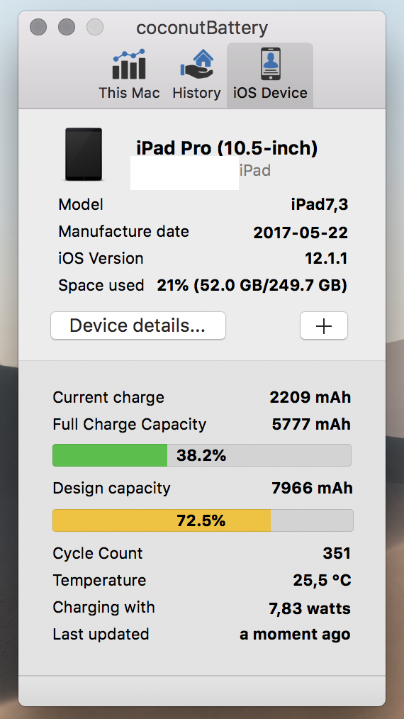

Just tested mine for the first time and I'm really disappointed. it should be around 80% after 1000 cycles, but it's much less already (72,5% which I can really feel in day to day use). Does anyone know if this can be exchanged as a faulty part even if it is older than one year? (Germany).
This iPad keeps having issues, first the bright spot above the home button and now this.
I would definitely contact Apple. In practice the warranty is two years in the EU. Pretty sure you’ll get a replacement - assuming Coconut is even close to accurate. That kind of degradation for sure isn’t normal.

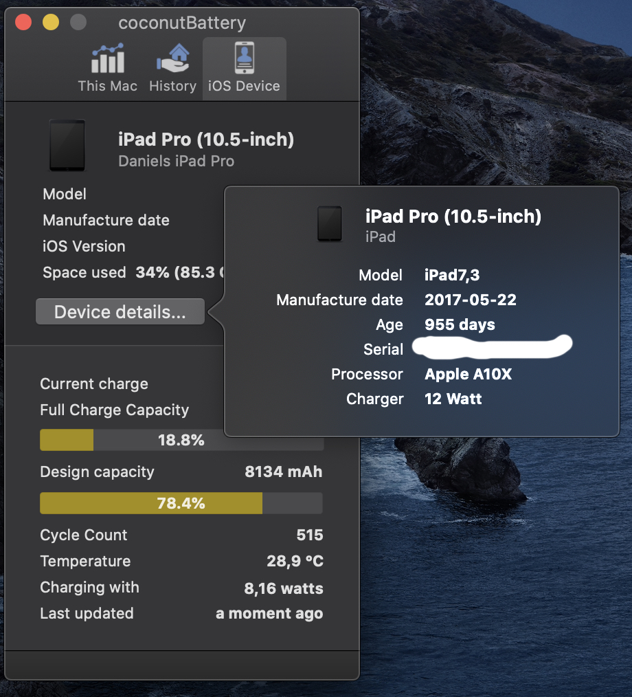

My battery has gotten really bad. Just checked it in CocountBattery and it doesn't look good at all. Would you guys say my battery is normal considering my rather heavy usage or could there be an underlaying issue? At this rate I don't think my battery will last the year out, which I kind of need it to do.
I guess its not that bad, it is 2 and a half years old and Apple say 80% should be left after 2 years (500 cycles or is it 1000?), so it looks normal wear and tear. Don't know how much battery replacements are for these devices, I use mine a lot so I expect it to deteriorate. My MacBook Pro (2015) is 85.5% but then it is plugged in most of the time.
