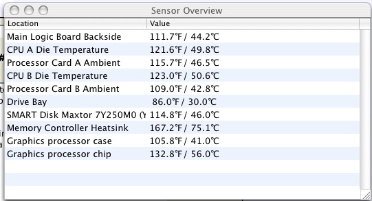

I have a DP 2.5 G5 and i love it. Although after reading through how queit tis supposed to be and stuff i've been starting to think that theres something wrong. I mean it's supposed to be real quiet with the liquid-cooling system.
Everything is stock... nothing has been added. (specs in profile) The Plastic strips have also been removed.
Its always at a constant hum and even opening a small app such as mail the fans screem. They also seem to go off just at random while sitting idle. and when opening a finder window.
Am i just being anal or is this a problem?
Also i'm not sure how hot this thing is supposed to get while just sitting using Firefox but heres the temps
maybe other DP 2.5 owners can describe how loud theirs get and the heat of the comp while being idle
Thanks for you input.

anyone?
i should add that i'm running the newest of everything... including the firmware.

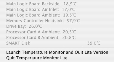

I have a dual 2 Ghz G5, and it's really quiet. My temperatures are much lower than yours (see the attachment). My room is only around 21-22 degrees warm, and the Mac is sitting on the floor where it's extra chilly.
Anyway, it's very quiet, and all the fans are spinning at low speed constantly. Only after I've run both processors at 100% for some minutes I can notice that it really start to speed up the processor fans. Especially when going from 100% over a few minutes to 0% to 100% again.
What kind of graphics card do you have? I have the stock Radeon 9600 Pro without any fan. I'm planning to get a X800 very soon, and it might be noisier. Hopefully not that much though.

wow my memory control heatsink is 20 degrees C hotter than yours.
does anybody know how hot these are supposed to be?
Mine is quite hot ... 70C! ... Actually the whole thing is hot, around 35-40C. Then again, it is on 24x7
