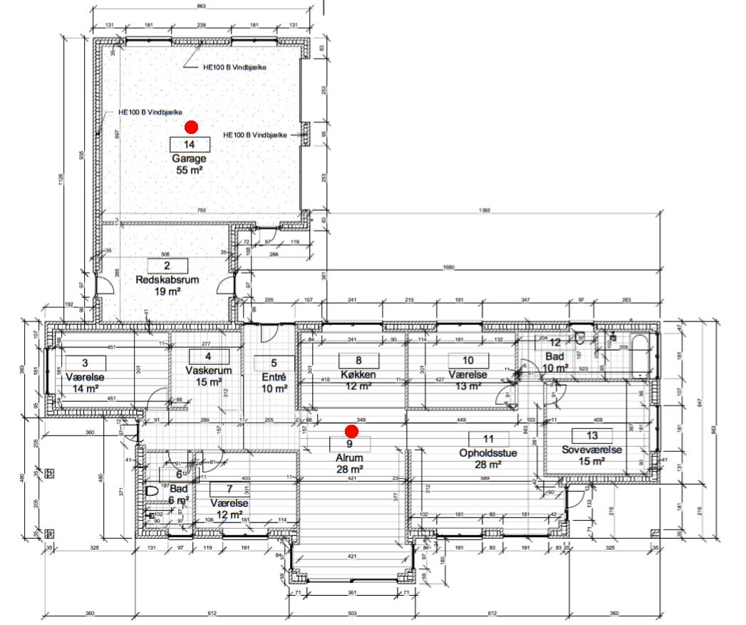

We are building a new brickhouse, both inner and outer walls are made of bricks.
We want a fast and stable Wifi, that will cover the whole house.
How many access points do we need, and where should we place them?
Our own suggestions looks like this: (the red dots is a access point)
1
2
3
4
Which one do you thinks will work best, and do you maybe have a better solution?

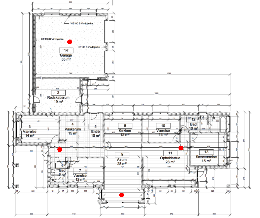

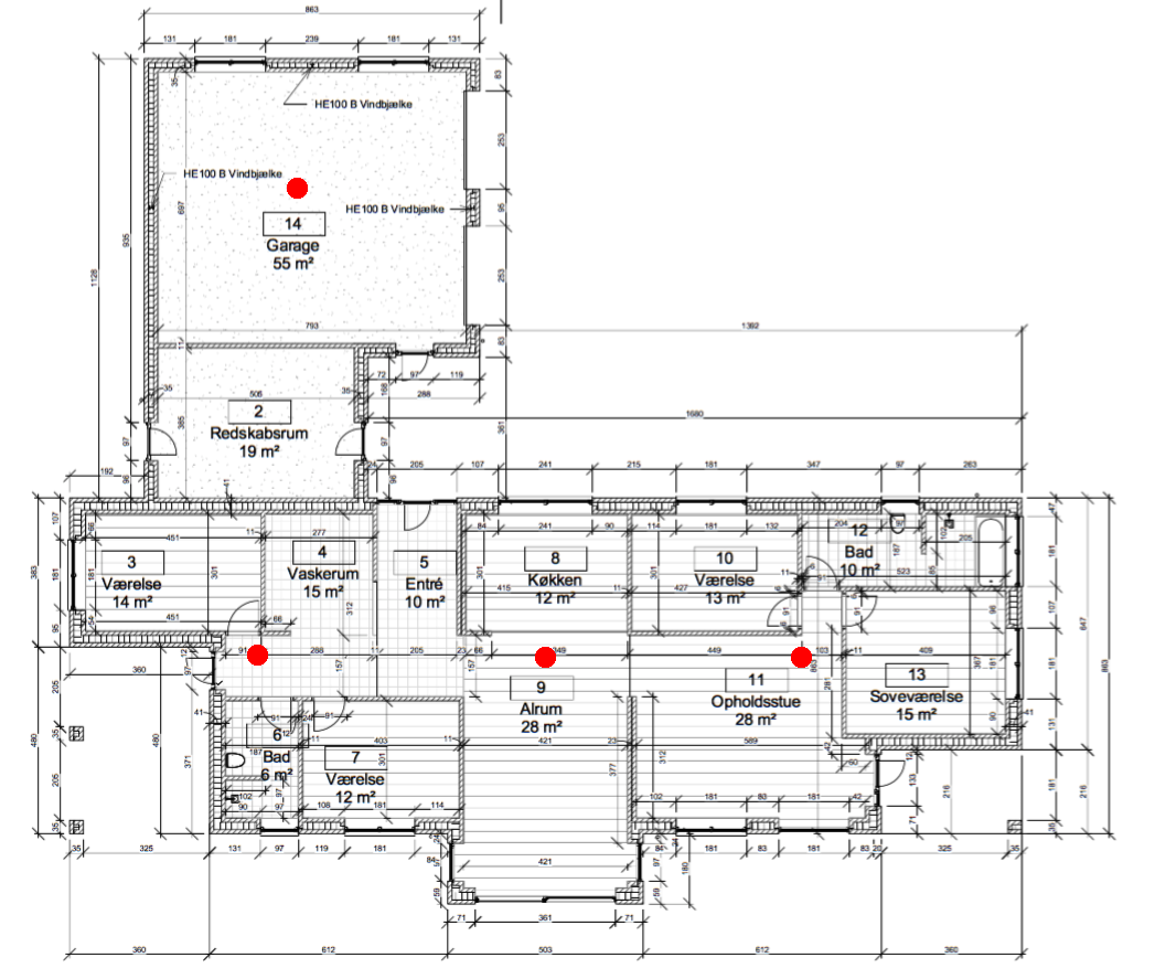

Will the house be wired with Ethernet? I.e. is every access point connected to the local network through a wire? I would say 3 will be the best, but I would start with 1 first and then get more APs and move from 1 to 2 and 2 to 3 if needed.

Every access point will be connected to the local network through a wire. I think the access point will be Xclaim Xi-3.

I am familiar with brick/concrete construction, I would start with 3 access points... (I have 4 in my house, with similar wifi-hating concrete construction but it worked just fine with 3).
@MatrixH Without doing a full site survey, I would recommend setup 2 or 3. As for APs, I highly recommend Apple AirPort Extremes or the Ubiquiti UniFi line. I deploy networks all the time, and could create a list of all of the parts I use in a situation like that.

4 if the rear doors lead to garden space. I'd avoid airports for this setup
