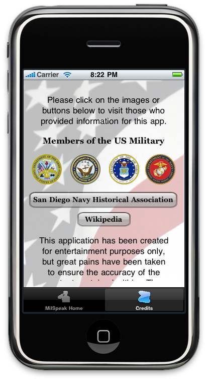

Here's a question - I have a view containing buttons that I currently use to call up Safari, as shown in the attachment. Here is the code I'm currently using for this call (the buttons all use the same code, but with different URLs):

You are saying that I can use this view controller to call up another view controller (the webview) to display that URL, right? I'll have to change the code for the method, of course, but I can research that part of it.
With respect to your last suggestion, the view controller in the attachment activated via the second tab on the tabbar, so I'll most likely end up adding a second navigation controller for the webview.

Right, one view controller can create and push another view controller onto a navigation controller.
You should look at Settings.app and think about how it implements all the different views. Download some free apps from the app store. Many games are a little different and add and remove views directly from the screen but most other apps will use navigation controllers and tab bar controllers to add and remove views, each one controlled by a view controller, from the screen.
You should of course read apple's view controller programming guide also.
