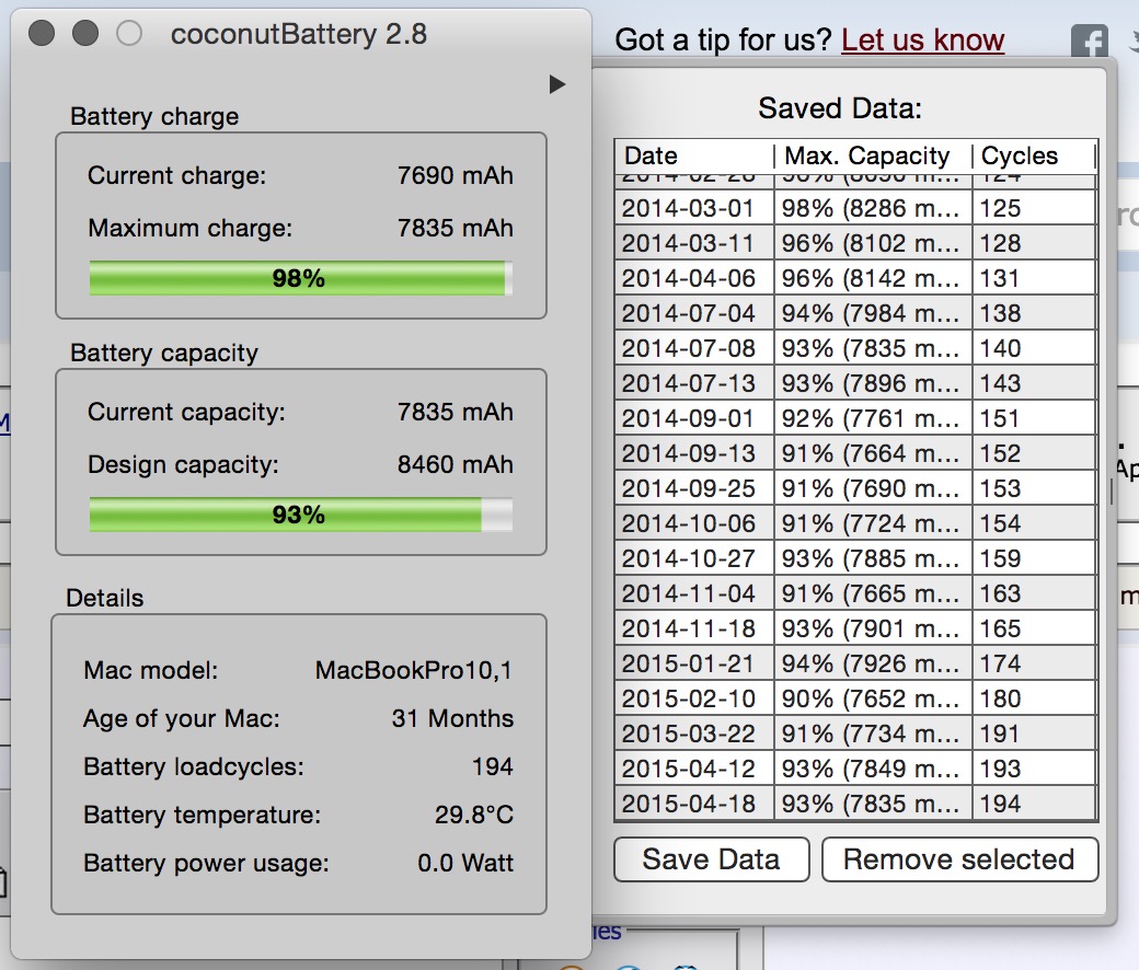

mac battery ..
I usually keep my MacBook Pro plugged into the adapter .. that's A LOT of cycles, you're talking about .. I've had my rMBP for three years now .. and my cycle count is less than 200 .. and the battery capacity is at 93% ..
