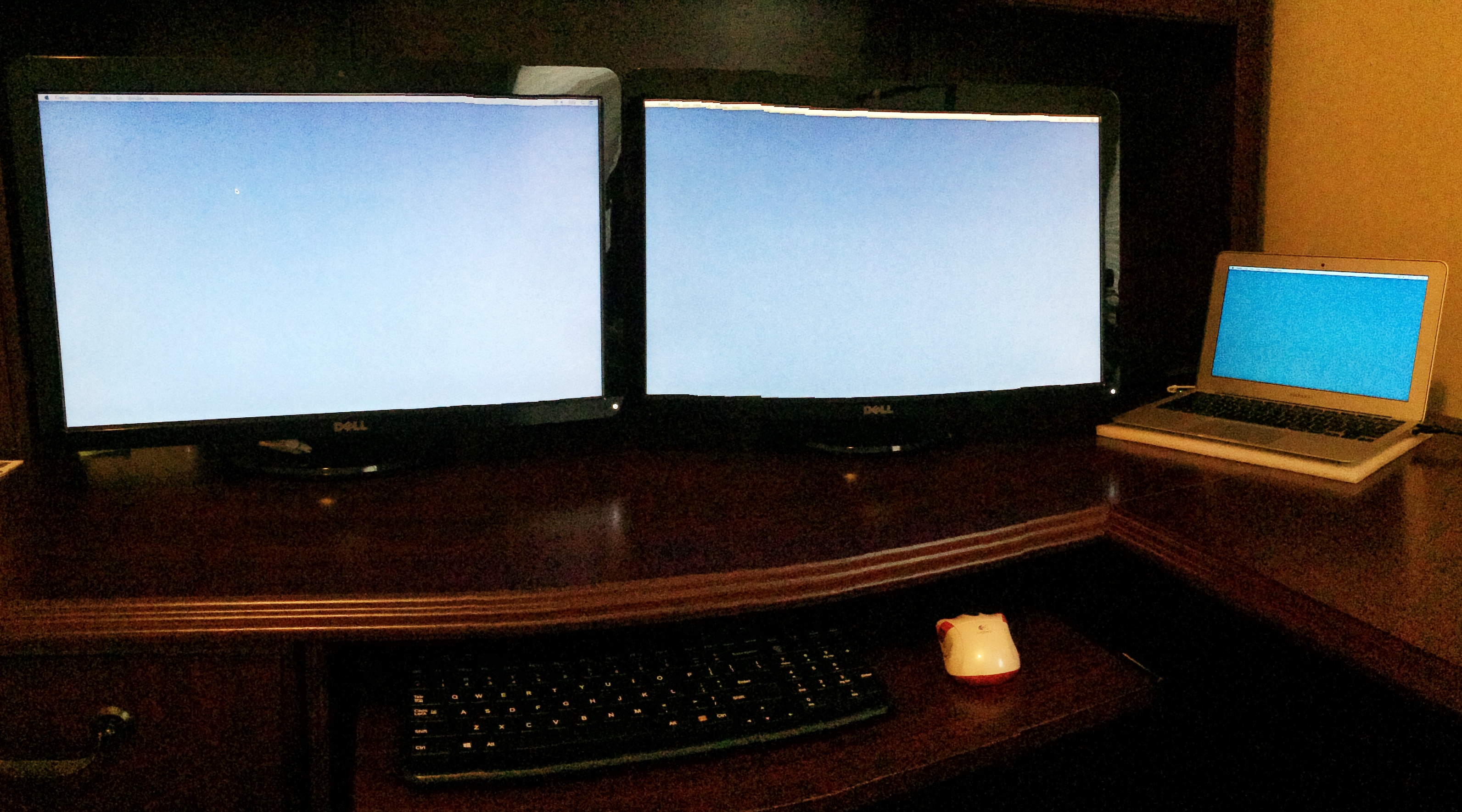

I have an 11" MBA w/ core-i7 + 8GB RAM + 256GB SSD arriving tomorrow from the refurb store. It's replacing a 2009 Mac Mini, to which I've had dual 1080p monitors attached since I bought it. I'm planning to use the same two dual monitors with the MBA when it arrives--one connected via the minidisplay port of the MBA, and the other connected via a USB-to-HDMI adapter.
Just curious how many of you MBA owners are doing a similar dual external display setup. I've seen various posts about how to do it, but now I'm interested in how many people actually do it, and if they are happy with the setup. Thanks in advance for all replies!
I set mine up with 2 external monitors this morning. One is connected via mDP to DVI cable, the other via USB-to-HDMI adapter + HDMI to DVI cable. Both external monitors are running 2048x1152. As you can see in the attached pic, this also works with the MBA display as a 3rd display.
Overall, quality is satisfactory, but not great. The USB-to-HDMI adapter is not an ideal solution. Though not horrible, doing anything on it is a bit jittery. For example, the mouse cursor does not glide across the screen as smoothly as it does on the screen connected to the mDP port. Also, if I drag a photo or a window from the mDP screen to the USB screen, the photo or window will turn black for a second or two before showing up again. Almost as if the USB display takes a brief second to register the contents.
I think these are just limitations of a USB display. As far as I can tell, it's not really taxing the CPU in any noticeable way, and I didn't notice any performance slow down.
I think this setup would work for somebody doing primarily office-type tasks, but would probably be pretty bad for video and photo applications.
I'm still on the fence as to whether it's good enough for me or if I would be better off with a solution that does not require a USB display adapter, such as the rMBP 13" which has two mDP and an HDMI output.

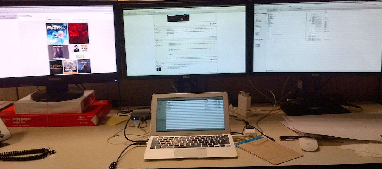

I use my 11" MBA with three external monitors, all 1920x1080. One is Thunderbolt to VGA, the others are connected to USB video adapters. As the previous poster mentioned, it is not that great for movies, but I use them at work for CAD and office tasks. The four-monitor system works great for that. The little MBA runs all the monitors just fine.
