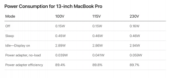

https://www.apple.com/environment/p...ch_MacBookPro_w_Thunderbolt3_PER_June2017.pdf
Here is the info for the 13" MBP from Apple's PDF link above.
