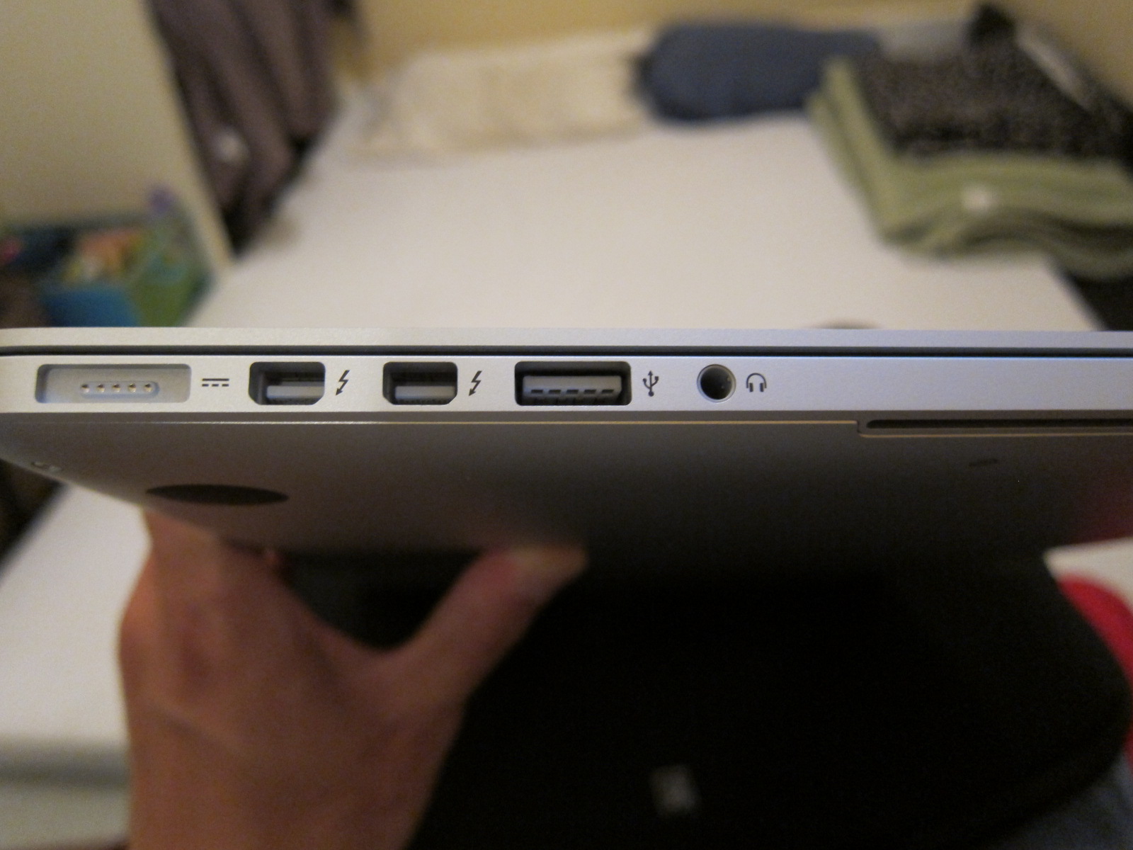

I attached a photo of what one can clearly see is a gap on the bottom case - it was worse on the Thunderport side.
