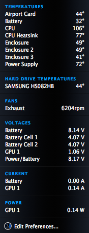

My 1st gen MBA has taken to overheating horribly lately.
I suffered the "kernel_task" issue, so I installed CoolBook.
I no longer get the kernel_task going nuts, but once my MBA hits 106 degrees, it puts itself to sleep, sometimes it shuts itself down completely.
in short... 106 degrees is a killer.
