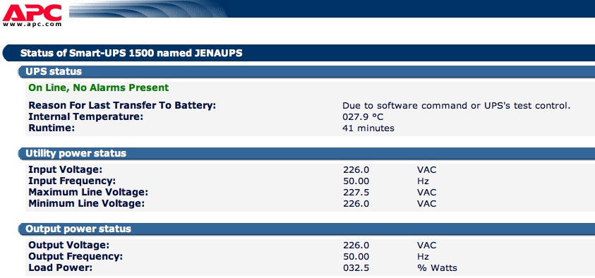

At this moment on my APC SmartUPS1500 (980Watt), from the (optional) Network Management Card AP9617:
MacPro 2008, 2x2.8Ghz, 8GB, 2xWD7500AYYS, Radeon 2600XT, Eizo HD2441W 24", Eizo L685 18", Router Cisco 877W, Canon MP970 printer/scanner, Klipsch Promedia 2.1.
32.5% of 980W = 318.5W
When the monitors are in standby, Load Power is 21% more or less...
