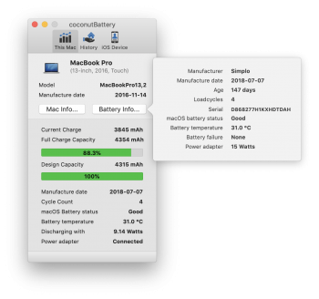

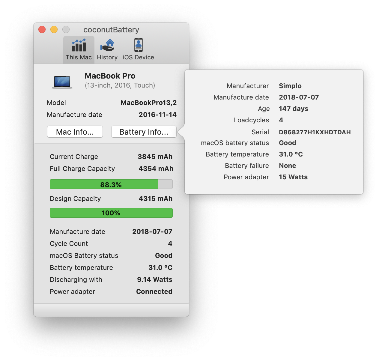

Here's what Coconutbattery says on my 13" when I plug it into my 15" using the USB-C cable from the Apple charger. Charges it with 15 watts.
