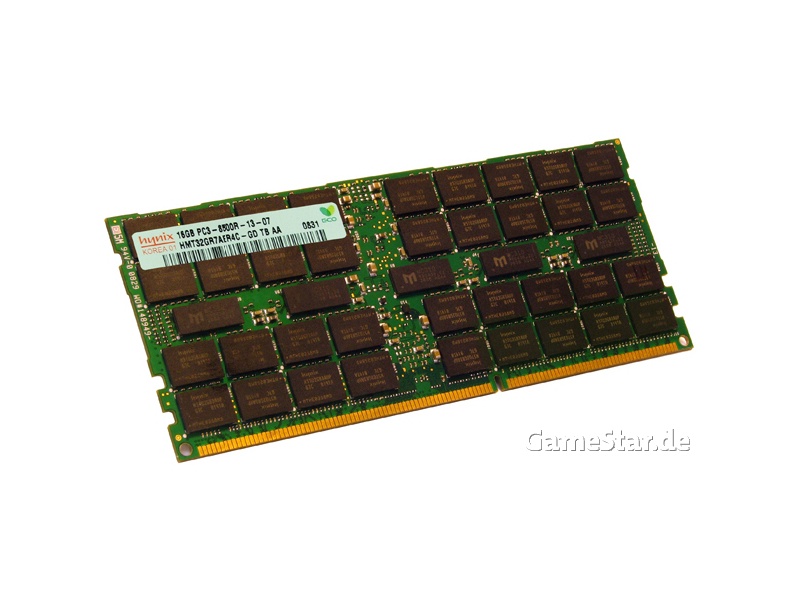

Those are 16GB modules... 😀 Some odd german company. 😛

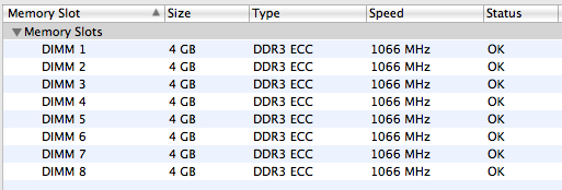

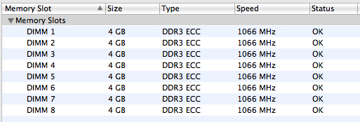

I have the 09 model, I took a real hit on the price but it was time to upgrade. Here is a beautiful screen capture.
EDIT: Can you imagine 32GB X 8 slots. 256GB of RAM 😀
