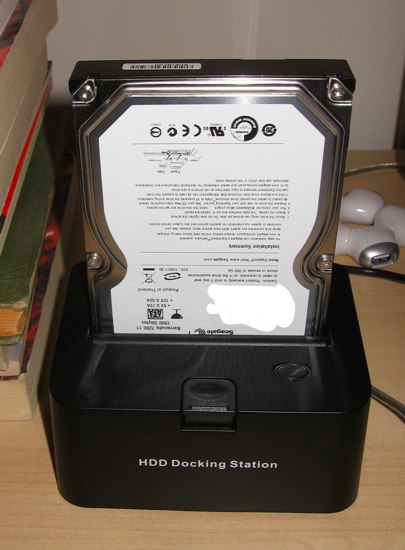

If that drive's gonna be for just backup purposes, even a FW400 should suit fine.
But i strongly recommend you to go for a dockable solution.
