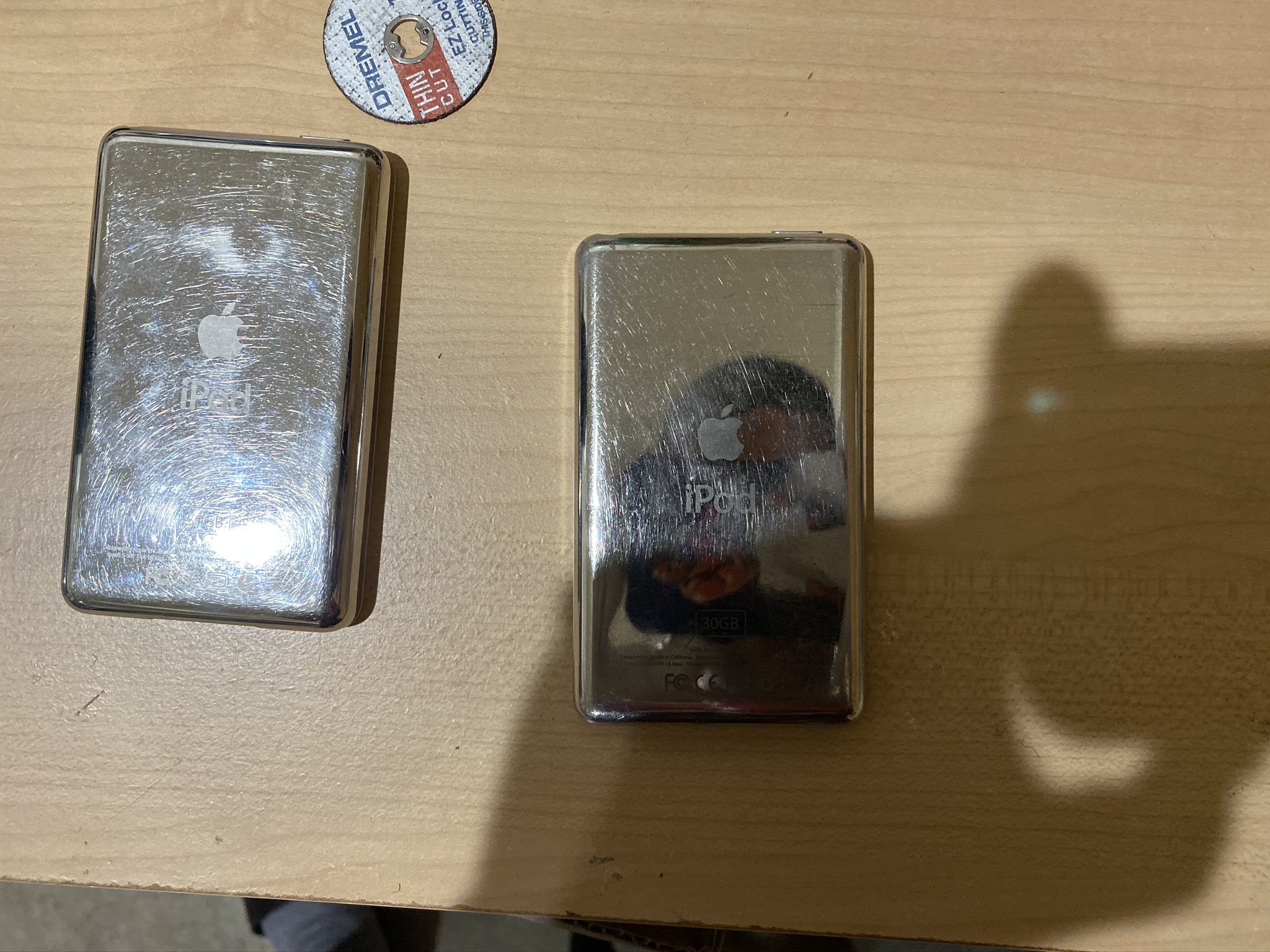

Here is a picture of both the iPods before I started:

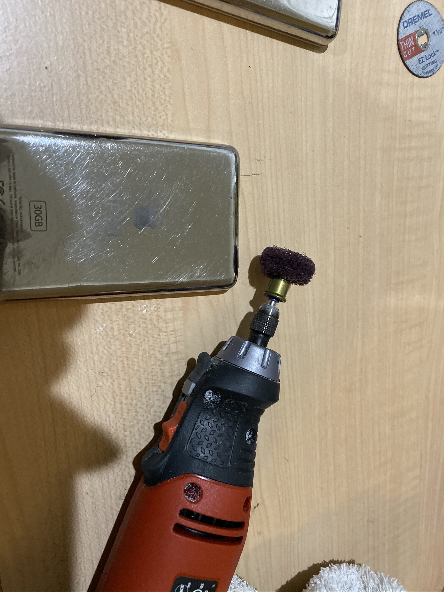

For the first trial I used just the Mag polish with a buffing wheel and this is what I got: Notice the letters got darker although the mirror polish, it kinda of faded the logo:

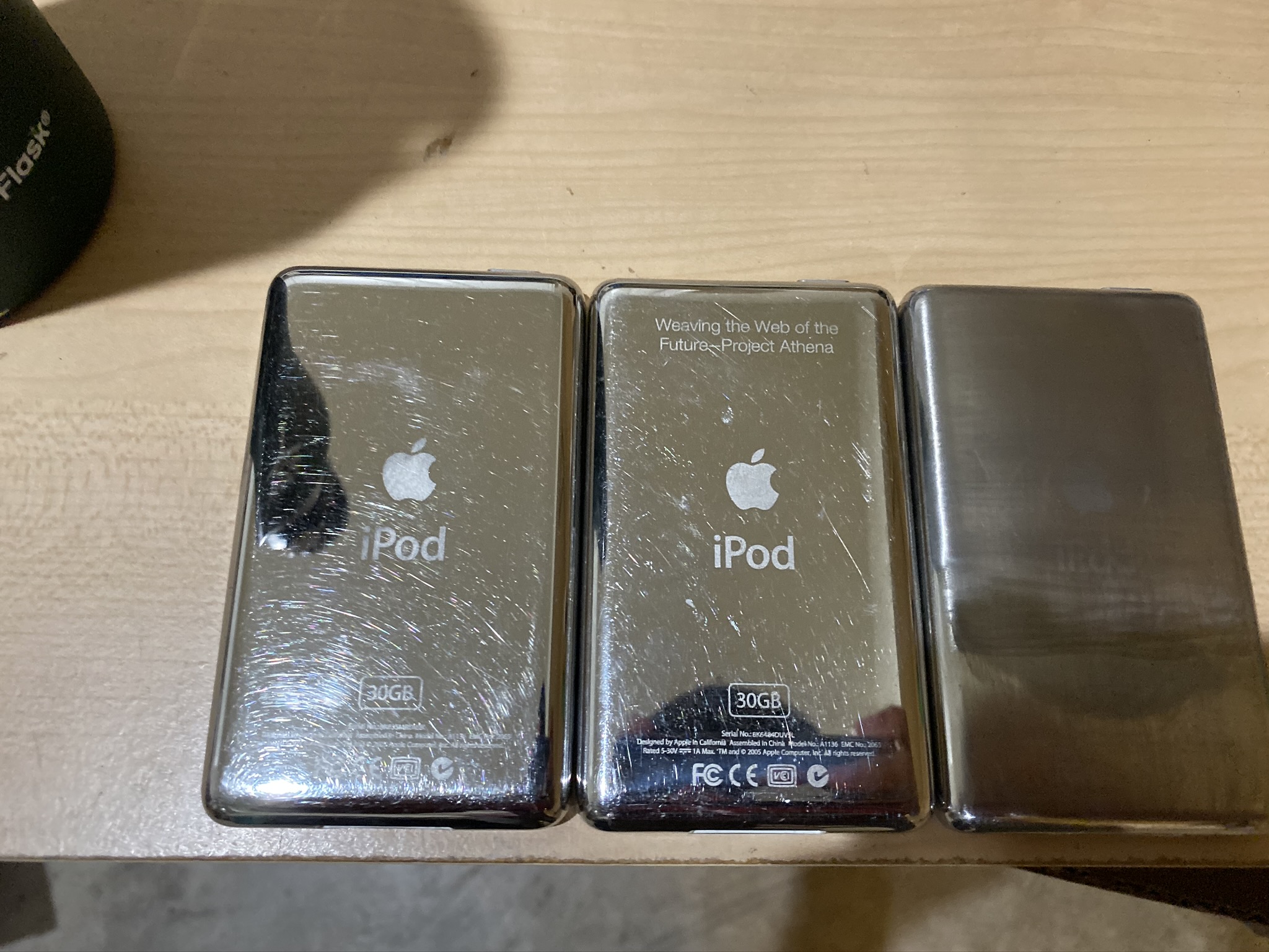

As you can tell that wasnt a good idea, proceeded on to place some turtle wax only on another ipod and got this result( The ipod with weaving the web is the ipod only with turtle wax, and the iPod to the far left is just a control which nothing was done to but to show you the original mirror finish, the far right is what happened with the Mag polish and trying to sand it with the least abrasive tool in the kit)

The logo and etchings are just controlled abrasions. To that Dremel they’re no different than scratches. If it were me, I’d do it all by hand and would never use any kind of power buffer.
Aren’t those aluminum backs? I’d use 6000-8000 grit sandpaper and avoid going over the non-etched areas (or at least mask them). Then I’d polish them by hand using microfiber cloth and some metal polish (not car wax).
Wet/dry sand with a very VERY fine sandpaper, followed by a mildly abrasive metal polish on a soft cloth will get that up to looking like new.
You only need the dremel/power tools for very deep damage/hard surfaces.
