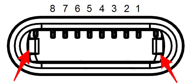

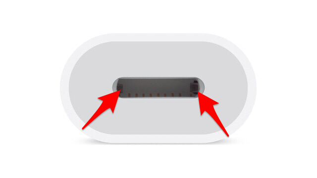

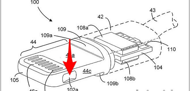

I mentioned this in your previous thread (which prompted this new thread) and I'll highlight here what can break inside the Lightning port in the iPhone for others who might be curious.
The male lightning plug on the charge cord has a notch formed into each side of the plug to grab the spring retainers inside the Lightning port in the phone. The male plug has eight contact pins on each side, but only one side is used at a time. Each side is redundant.
The female port in the phone only has 8 contacts on one side. That design allows for the male plug to be inserted any way, upside down or upright and one set of contacts will always mate with the single set in the phone.
Inside the female lightning port in the phone on each edge is a spring retainer tab whose purpose is to grab on to the notch formed on each edge of the male lightning plug. It locks the plug securely in place and you can feel it grab when you insert the plug with a distinctive click.
After a certain number of insertions and removals of the Lightning plug (thousands) the side locking spring tabs inside the iPhone port can break and then the male plug won't be held securely in the socket and the charge connection will always be erratic. Error messages can occur on the screen while charging and if the plug is jiggled enough times, the phone will no longer accept a charge no matter how the plug is inserted, and it will have to be rebooted to start charging again.
How often iPhone charge port spring retainer tabs break is something that only a repair shop or apple really knows. All I know is that after about three years, one of my spring tabs is gone and charging must be done carefully. Can't use the phone while it's charging otherwise the connection will break.
Here's some images to see what's what. You'll need a good magnifying glass and carefully directed light shining in the port to see what going on in there.
Most erratic charge cord connections are caused by packed lint in the port preventing the plug from inserting fully... But not always.
