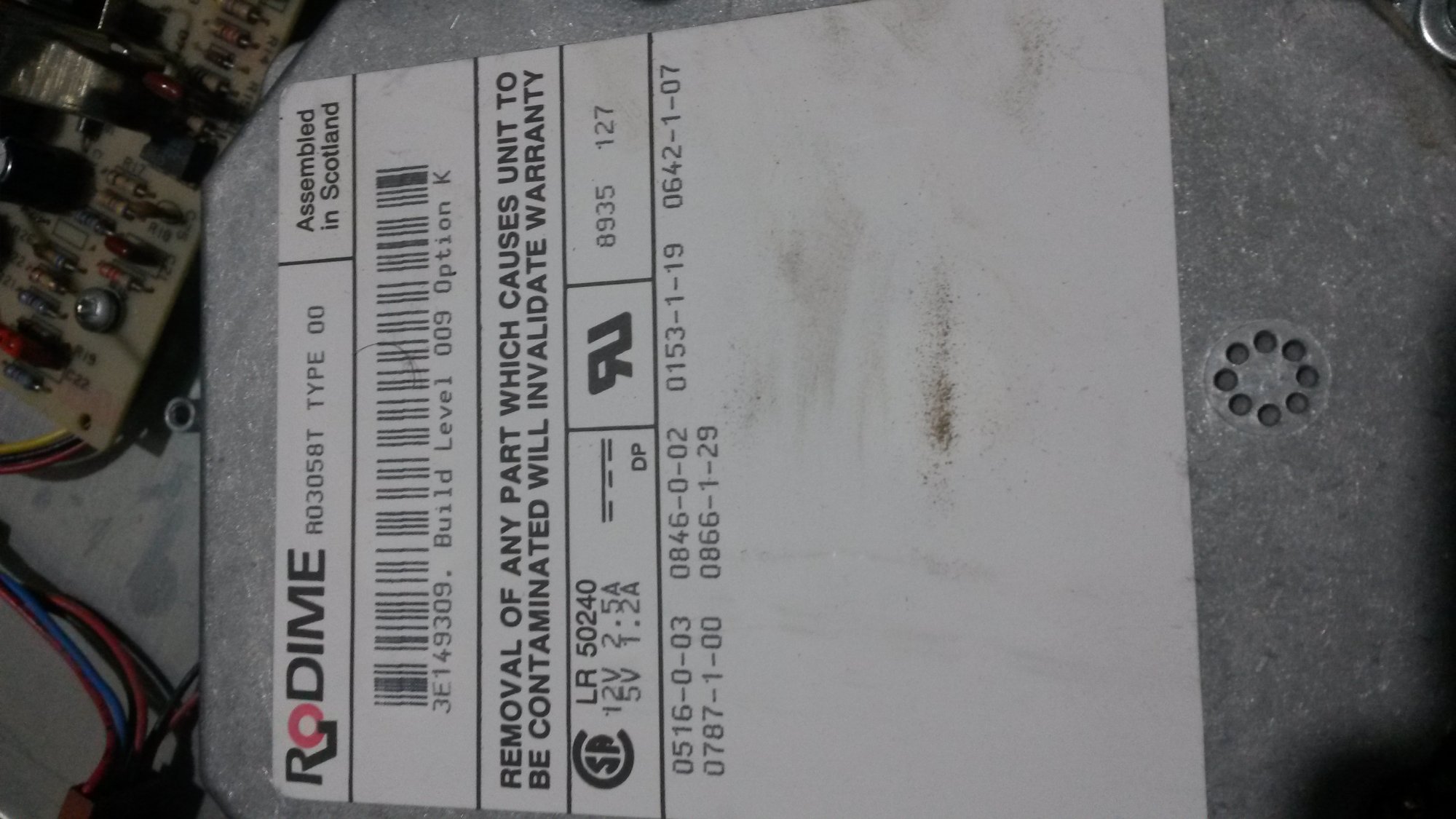

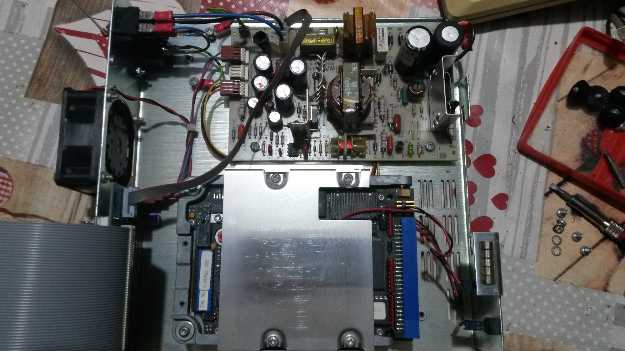

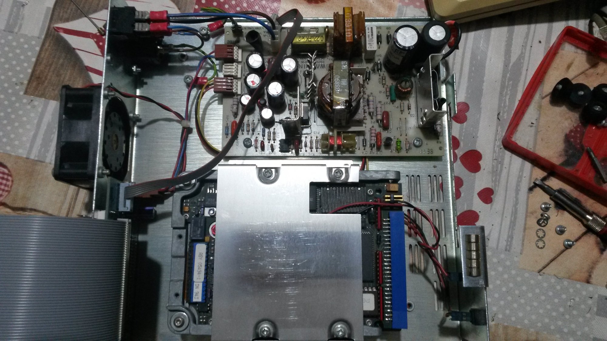

Here some pictures. Questions:
- turn on: turn on hard drive and after 10 seconds screen? ( I tried both).
- on back part, there is a red switch, position 1 selected
- two scdi ports on hard drive, preference? (I tried both)
At this moment, when I turn on screen looks black (before, I got error and seems be hard drive without magnetism)
I tried turn on with system floppy and use tool to found HD, nothing happen, just the clock thinking

OK, it's a plain SCSI drive.
Have you had this working previously?
Do you get an error code if you turn on the HD first, then the Mac (without a boot floppy) and wait? Take a picture of the screen if possible.
The SCSI being set to "One" should be fine (the red switch on the back).
It doesn't really matter which SCSI port you use on the back, however, you should fit a SCSI terminator to the un-used port.
It's quite possible that the drive has failed, which would be reasonable given the drive's age, BUT there is more troubleshooting to do before arriving at that diagnosis.

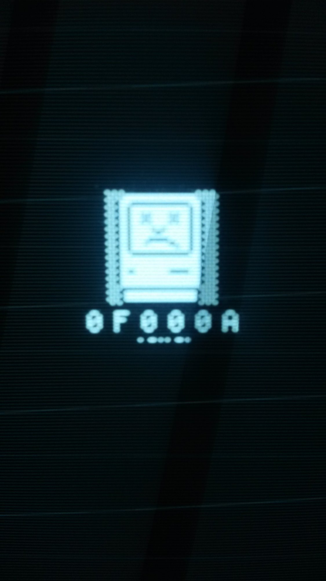

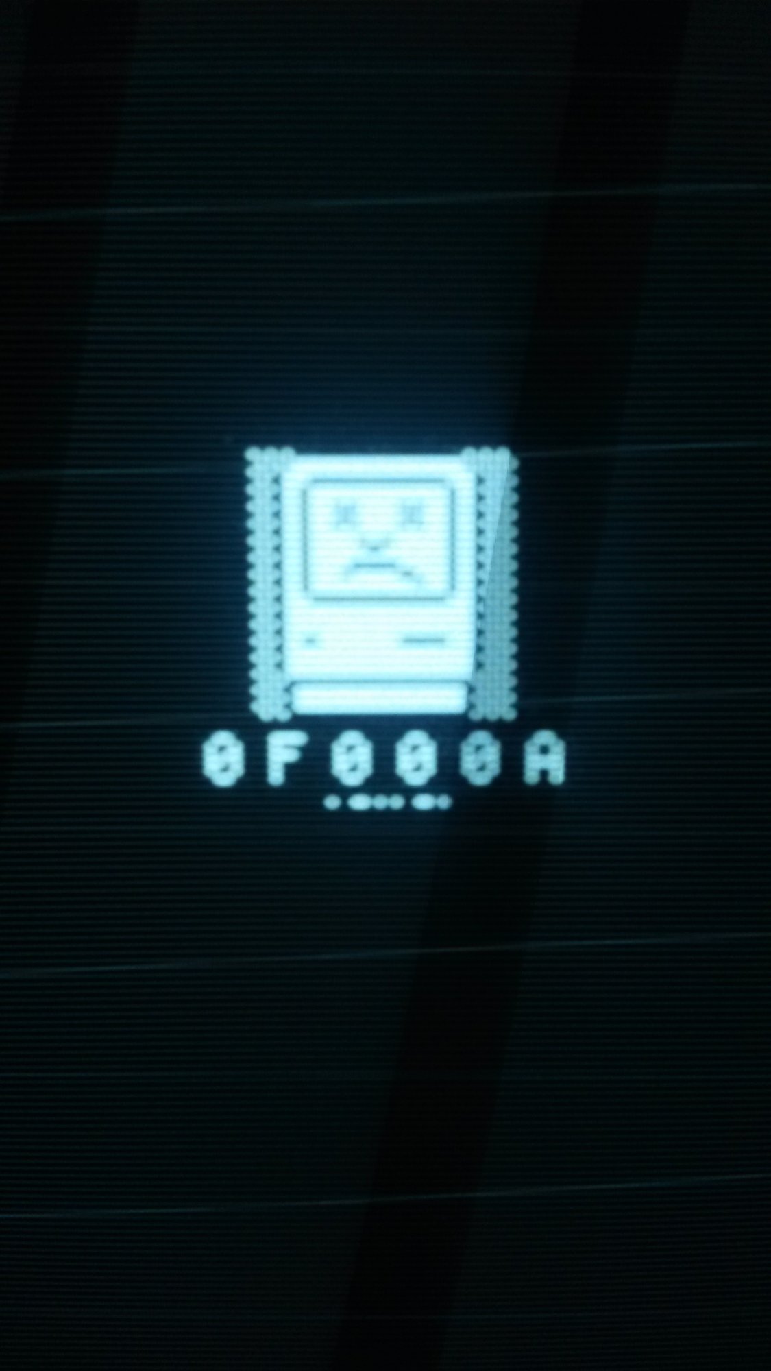

After turn on the hd and after screen without floppy disk, I get black screen. After some combination,if after turn on hd+screen, reboot screen with back button on the side I get error code (attached file).

After turn on the hd and after screen without floppy disk, I get black screen. After some combination,if after turn on hd+screen, reboot screen with back button on the side I get error code...
0F000A error code is most likely a corrupted partition map on the drive. IIRC some utilities (early "Silverlining") may be able to repair the problem (if that's ALL it is).
