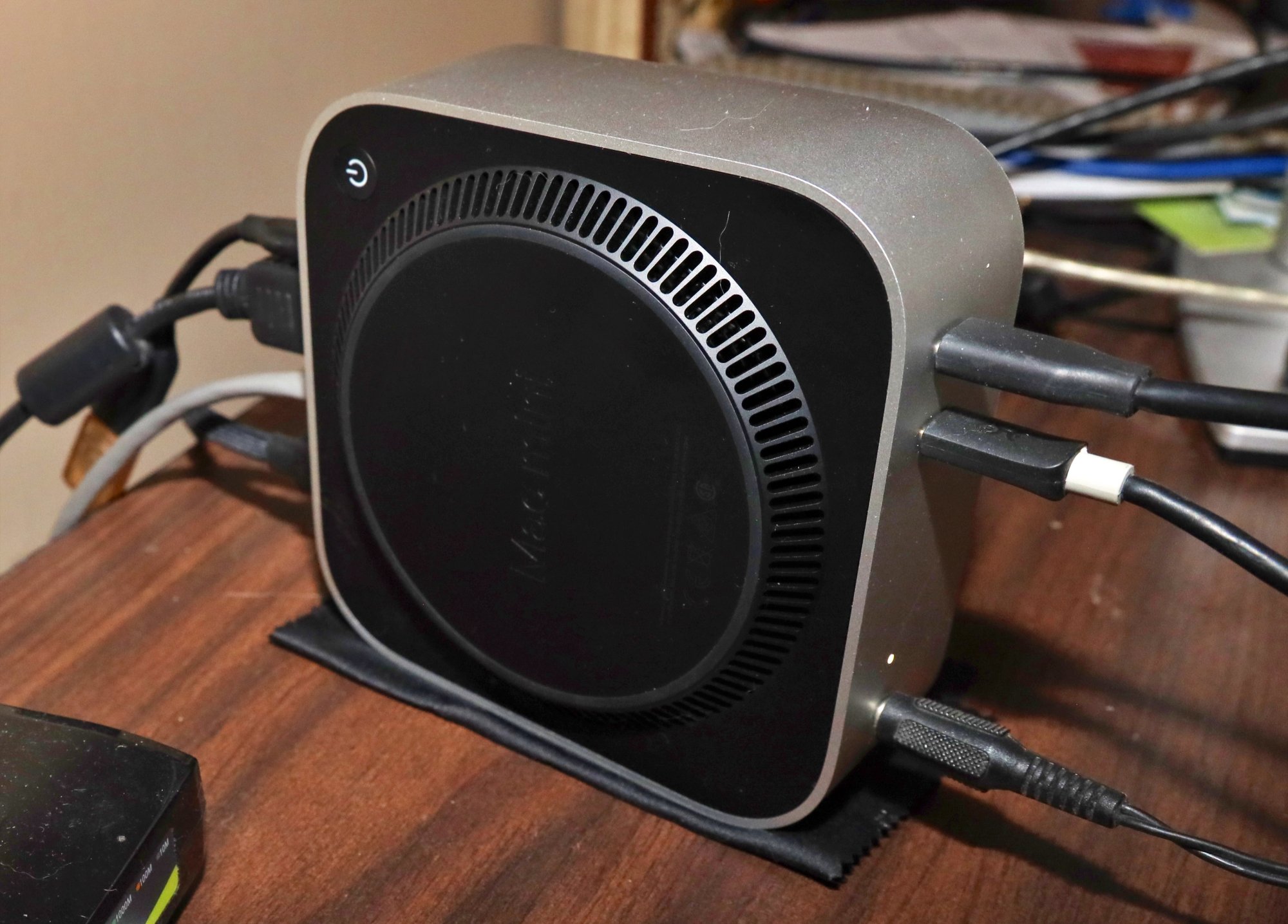

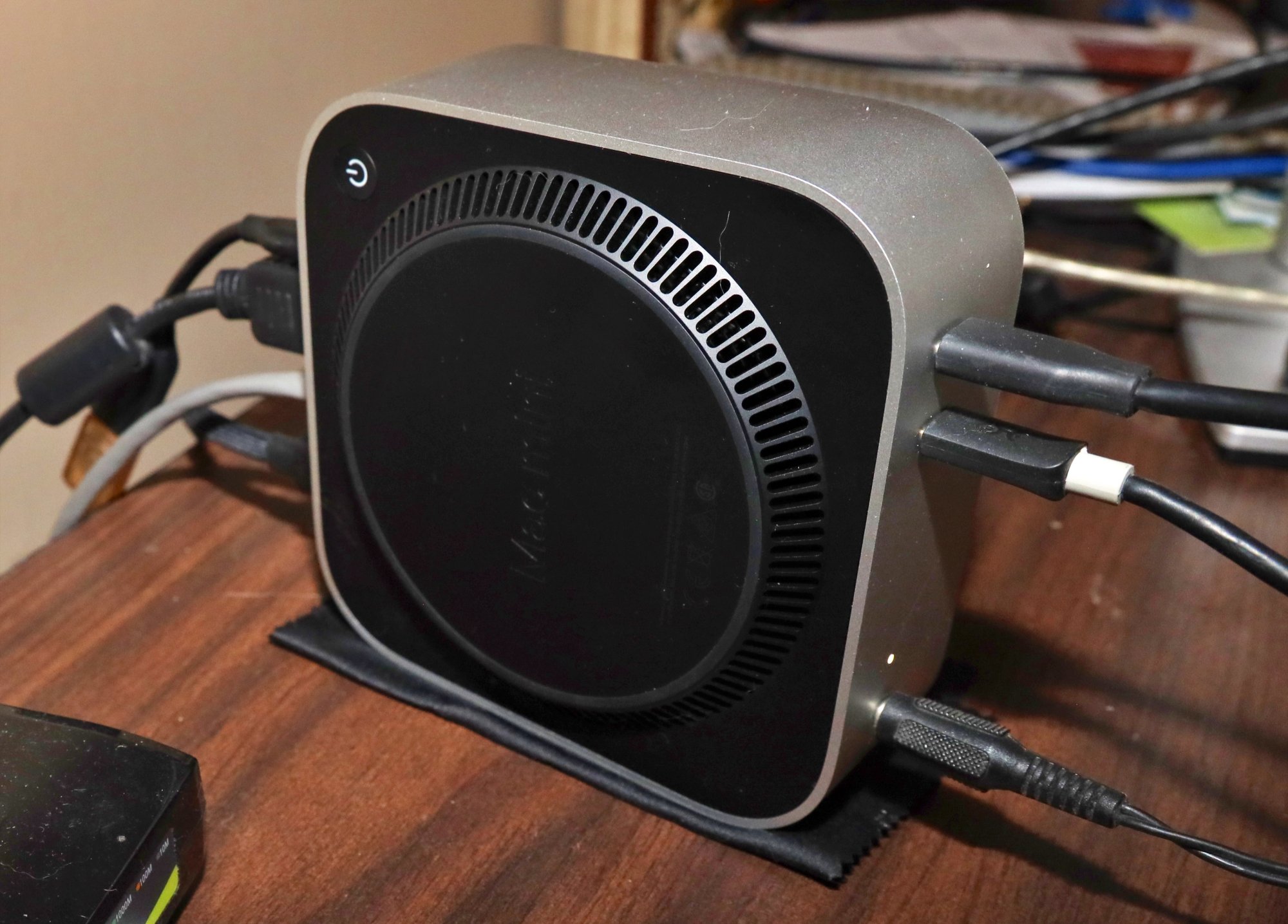

I had been thinking of starting a new forum thread on this... but since the subject came up... I'll post my experiences here.
A couple of days back, I started getting "freezes" on my m4 Mini. Or rather... they seemed like freezes.
The mouse cursor would no longer move.
I couldn't click on anything.
My keyboard didn't work, either (the mouse is a Logitech wireless with the Logi receiver plugged into a USB port on the keyboard).
It certainly seemed like the Mini was "locked up".
Only "way out" seemed to be a restart.
Then by chance, I got a freeze yesterday and decided to plug another USB wired mouse into one of the front ports on the MIni. Suddenly... the mouse worked again.
Hmmmm....
I reached around and unplugged/plugged the adapter for my keyboard cable and flipped it 180 degrees, and all was well with the regular keyboard/mouse again. Could have been "in" the cable adapter I was using (USBa to USBc), or perhaps the actual connection to the port (don't know).
So this wasn't a "software/OS freeze" -- rather, just a hardware disconnection.
But... I noticed something else to which I hadn't paid attention before.
The USBc/thunderbolt port on the back of the Mini... well... it seemed to "flex" a bit.
Both "up and down" and "left to right".
It moved. Not as "solid" as I would expect it to be.
I keep my Mini "upright on its side":
So... I did a little cable re-arranging to reduce (as much as possible) any "strains" on the connection point into the Mini.
I'm wondering how this will progress into the longer-term.
For anyone reading this who has the m4 or m4pro Mini:
Do your USBc/thunderbolt ports (both front and rear) seem to have some "flex" in them when moved around...?
Hmmmm....
If you look at any of the Mac Mini teardowns (starting with step 30), both the front and rear ports are modular in nature, which allows for easier replacement if a port was to stop working. I wouldn't worry about the flexing, as that is related to how the USB-C ports are actually built into the Mini.
