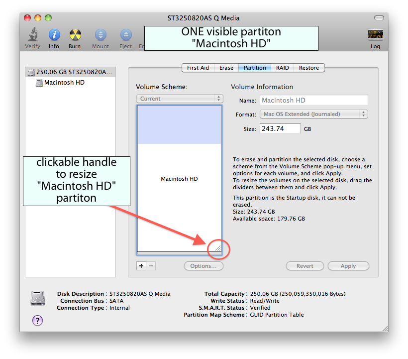

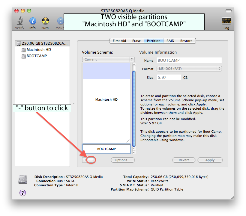

Open Disk Utility go to the partitions tab highlight your Boot Camp partition and then hit the "-" icon or press delete.
Then drag the bottom right corner of the Mac OS X partition downwards to fill the available space.

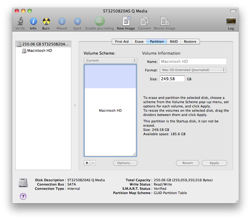

Click on the magnifying glass in the top right of your screen.
Enter "Disk Utility" in the textbox and hit return.
When it opens, select the entry in the top of the left hand column. This is your main hard drive.
You should then see "First Aid", "Erase", "Partition", "RAID", "Restore", select "Partition" in the right panel.
See this link for a visual guide.
http://www.creativetechs.com/iq/leopard_disk_utility_can_resize_partitions.html
You should now see two partitions in the graphical view. Select the lower one (Boot camp) and hit the (-) icon below it. Then, follow the instructions in the linked guide to resize the partition.

i've done everything you've said but:
first i'm a Tiger OS user, i dont know if this changes anything.
and i don't see the "-" icon.
i tried to delete i and the icon isn't "pressable"
what if i use that "restore" thing.
there are too blank spaces: source and destination
if i put the windows disk on the source blank and the machintosh disk on destination blank. shouldn't it work? (whitout deleting any data in the computer)

As the Leopard introduced the resizing feature absent from Tiger, without deleting data, it matters.
Anyway, don't use the RESTORE tab, it is for restoring from a saved disk image, not for what you want to do.
It might be best to backup all your data via CarbonCopyCloner or SuperDuper to an external HDD, use the Restore DVD and erasing the partitions using Disk Utility while booted from the Restore DVD.
Then use the OPTION key to boot from the cloned backup and use CCC or SD again to clone the contents back.
Restart again without the HDD connected and now you should have a working Mac, if that removed the sluggishness is another question though.
