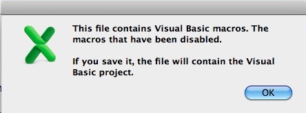

I've got this message
"This file contains Visual Basic macros. The macros that have been dislabled."​
every time I open Excel, even just opening Excel with no file. How can I stop it? Thanks!

Which version of Excel are you running? If it's 2004 that message is probably due to it not support VBA. No idea if it can be turned off but upgrading to the current version that does support VBA would probably get rid of it...
The OP's posted screenshot is clearly from Excel 2011. Also, Excel 2004 most definitely supports VBA.
