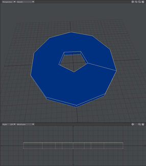

It depends which application, which application version. Also what plug-ins you've come to depend on too. For the app I most commonly use the short list of "limitations" reads as follows:
  • Octane currently doesn't support complex polygons or polygons with holes. To avoid artifacts user must work only wth 3 or 4 vertex polygons.
  • Octane is a GPU render engine. It can't use any kind of CPU shaders, materials, textures or any other kind of nodes available inside Lightwave. You must always use the Octane nodes to shade the objects. Lightwave material parameters like "T" texture layers or Lightwave nodes are not supported by the plugin. Only a few basic material parameters (color, diffuse, specular or transparency) are supported by Octane.
  • Lightwave native lights doesn't work with Octane. Users must use only the Octane light to work with Octane.
  • Octane has it's own color space functions and tone mapping. To work with Octane user must always disable the Lightwave color space (set all values to Lineal).
  • Lightwave color space functions are not supported by the plugin.
  • Currently Octane doesn't support ray visibility options, so all visibility options of Lightwave don't work. Features like all "unseen by" or cast or receive shadows are not supported.
  • Octane for Lightawave currently can't render particle systems. It also can't work with 1 or 2 vertex polygons
  • FiberFX is not supported.
  • Current version of Octane doesn't support Motion Blur.
  • Lightwave Image Editor options are not supported by the plugin. Octane read the maps from the files itself, and can't process the Image Editor options.
  • Limited region rendering is not supported by Octane.
  • This first version of the plugin doesn't support Octane Live materials within Lightwave.
  • Octane doesn't support multiple UV maps. User must be sure that each vertex doesn't have more than one UV map. To avoid problems it's best to work with only one UV map in each object layer.
  • It is also highly recommended that you have your Windows display adapter set to a non-Octane rendering graphics card (ie. your on-board graphics card, or a second graphics card).

Some apps allow single sided polygons (one single directional normal) to have many vertices. I think the point limit per-poly in LW for example is either 1024 or 2048 (I forget). So it's easy to create a condition where the normal encompasses one or several "holes". Here's an example object with two such normals (top and bottom):
Although best avoided IMO, geometry like this can be useful for low poly engines in like games, RT or interactive architectural walkthrus, and so forth. Of course the solution in this particular case is just to convert the faces to trips or quads.
Caveats aside the main point I was trying to make was that GPU rendering (as I see it) is still mostly confined to previews during the set creation (texturing, lighting, fine tuning animation, prop placement, etc.) and still frame rendering. Unless you love compositing (which I do) and then it's also quite useful for rendering out FX layers to be used in something like eyeon's Fusion - certainly my favorite. 🙂
