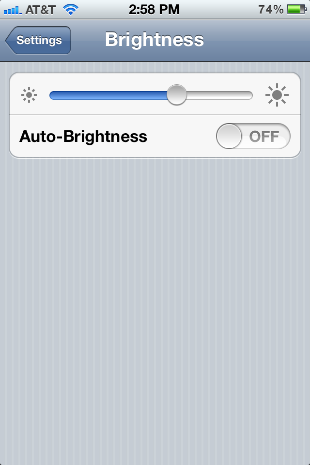

Some actual measurements
For a more scientific answer, I took some measurements of the screen brightness of my iPhone 4S with my light meter, when using the iLlumination app (setting the screen to be 100% white).
First to get reference brightness levels for 0% and 100%, I took measurements with Auto-Brightness off.
  • Slider at 0%: 4 lux
  • Slider at ~50%: 230 lux
  • Slider at ~65%: 323 lux
  • Slider at 100%: 650 lux
As you can see, the scale is not linear and you need to be past the middle point (as the screen shot shows) to get truly 50% of the range (323 lux).
And now, the measurements with Auto-Brightness on. I took measurements with the slider set at 0%, ~65% and 100% under a moderate low light (38 lux) and then took the iPhone under total darkness, a moderate low light (38 lux at iPhone position), and under a bright light (1820 lux at the iPhone position)
  • Slider at 0%:
    • Total darkness: 4 lux
    • Moderate low light: 4 lux
    • Bright light: 20 lux
  • Slider at ~65%:
    • Total darkness: 107 lux
    • Moderate low light: 224 lux
    • Bright light: 650 lux
  • Slider at 100%:
    • Total darkness: 615 lux
    • Moderate low light: 636 lux
According to the measurements:
  • When the slider is at 0%, turning Auto-Brightness on, only brightens the display when under the bright light (by 16 lux)
  • When the slider is at 65%, turning Auto-Brightness on, dims the display immediately under the same moderate low light by 99 lux, and futher by 216 lux in total darkness. It also brightens the display by 327 lux under the bright light.
  • When the slider is at 100%, turning Auto-Brightness on, dims the display under the moderate low light by 14 lux and in total darkness by 35 lux.
  • There must be a specific level of ambient light above which the screen doesn't dim immediately when turning Auto-Brightness on
