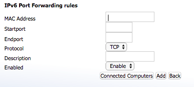

Coming back to the forwarding of the router to the host computer, I am now configuring the router on an option called ipv6 port forwarding rules. Is this the correct place to do that? One more thing, this will require that the host computer is always connected to the router and not to the time capsule, right? The settings asked for the port forwarding are:
Startport and endport is 22 right?

Are you using IPv6?
it's still port22 even if you are using IPv6
yes, the host computer does need to be on, and accepting ssh
IPv6 is the default option I get when changing the Port Forwarding settings. The MAC address would be the IP of the host computer right? I tried it like that and it did not work.
I need to read up more on ipv6 and ssh tunnels, but if you open terminal, and then run the command
ifconfig
it will show you the ipv6 address (called inet6 on a mac)
