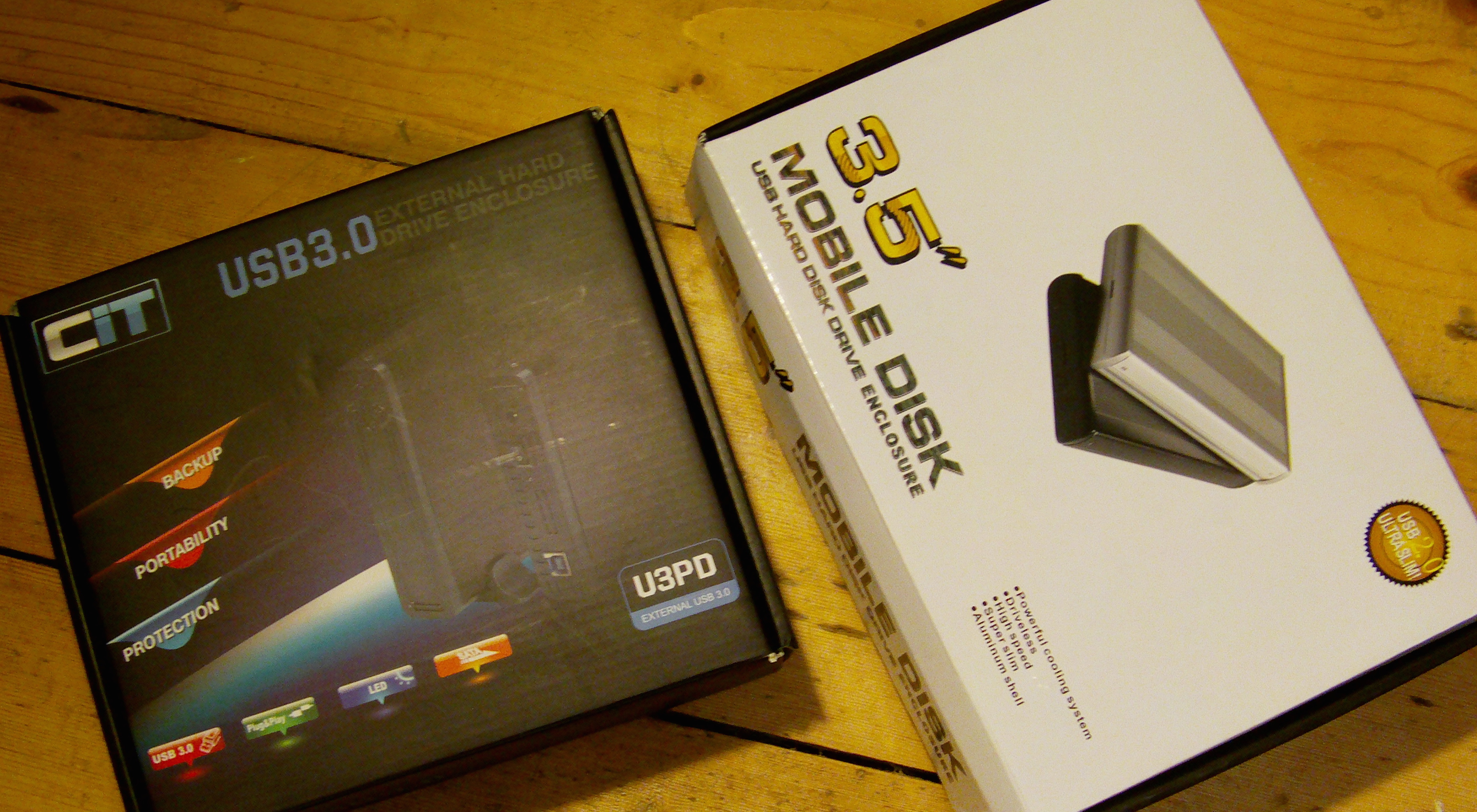

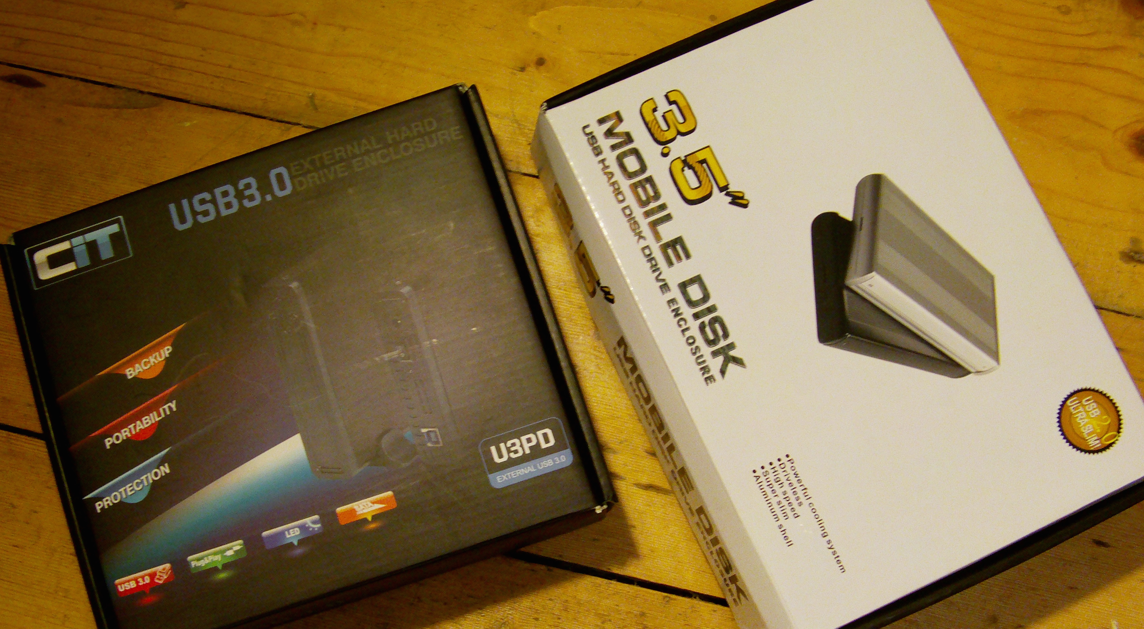

Thanks for replying guys 🙂
I have tried to install my WD hard drives inside a Caddy in the past. This is what happened:
The internal connectors were SATA so the WD drives fit inside ok, as they are also SATA.
The cables connecting the Caddy to the computer are USB. I would connect and power up the Caddy and it just didn't work.
Interestingly enough, I have been able to use other SATA hard drives inside the same Caddies and they worked fine. When I looked online for an explanation, other folks all warned about how Western Digital drives had trouble being read inside Caddies.
I have now found Caddies that warn that they work for all SATA HDDs except for Western Digital.
I currently use my 'black' Caddy, a CiT SATA caddy with a new Seagate Barracuda SATA drive inside with no problems. This same Caddy just didn't work with my WD at all. See attachment
Q: If you have a Caddy that works with Western D. please can you tell me which model it is?
Thank you.
PS: After posting this, I will try my WD HDD in a caddy one more time and post back here with a progress report.

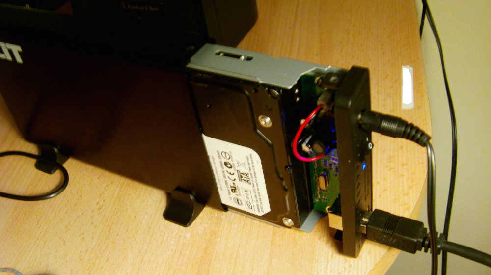

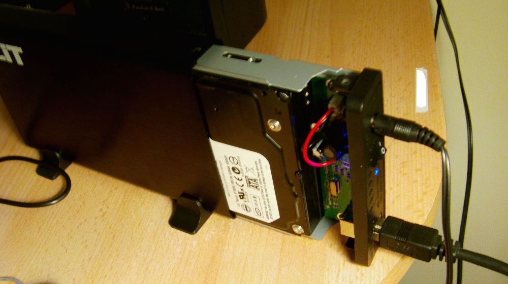

Thanks eyoungren,
I have just tried my WD inside my caddy just to double-check.
It still doesn't work.
In fact, I notice that it doesn't seem to power up / start whirring.
The caddy has power but the drive doesn't seem to respond to anything. 🙁
Perhaps the caddies you posted will work.. but if your WD SATA drives connect to the inside part of the caddy via SATA power and SATA data ports (as mine do), I don't see how they are any different to mine... 😕
Both Western Digital SATA hard drives don't spin / start up
