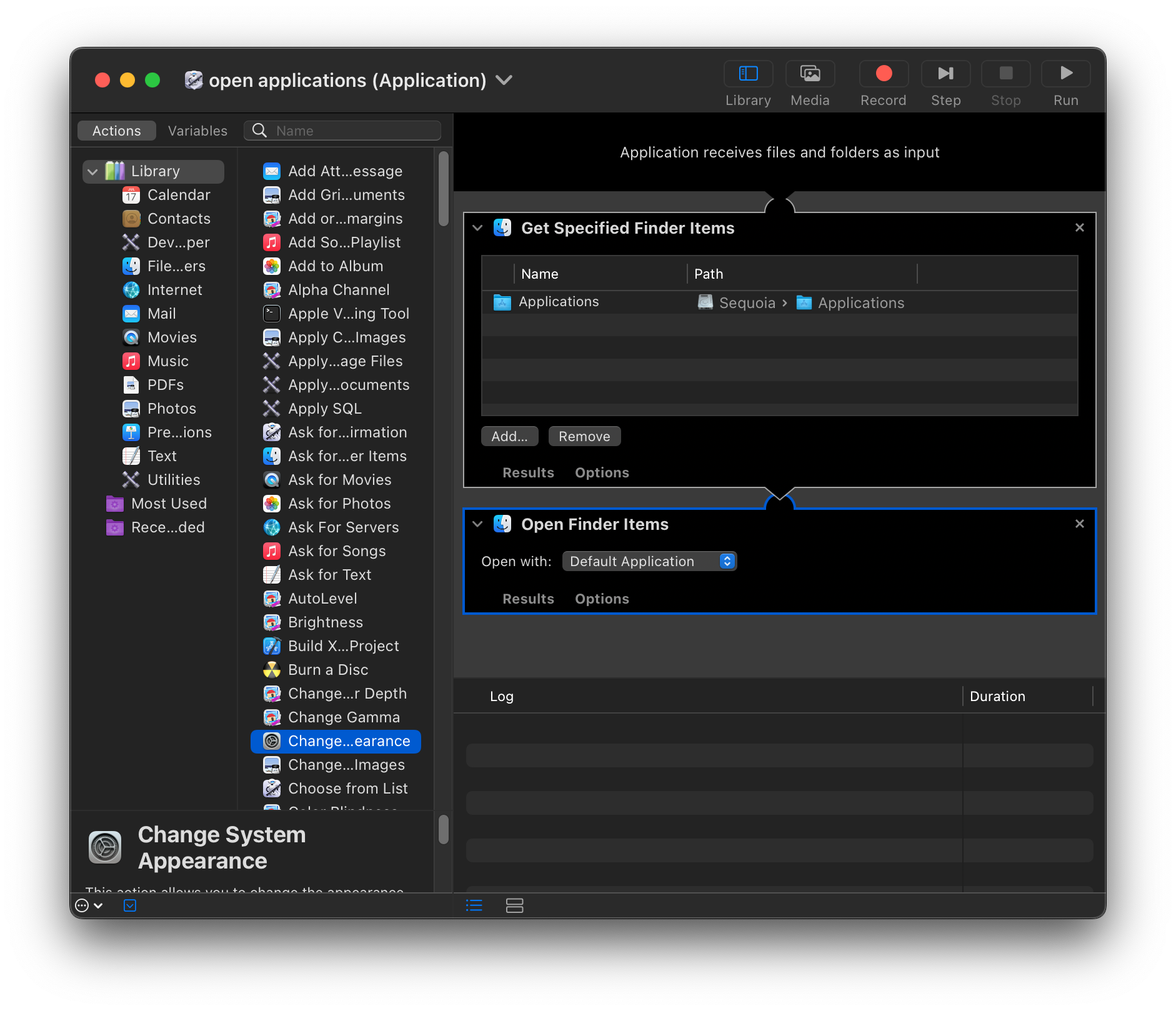

You could use Automator to create a simple application to do that and put it in the dock.
Reactions: kukata81

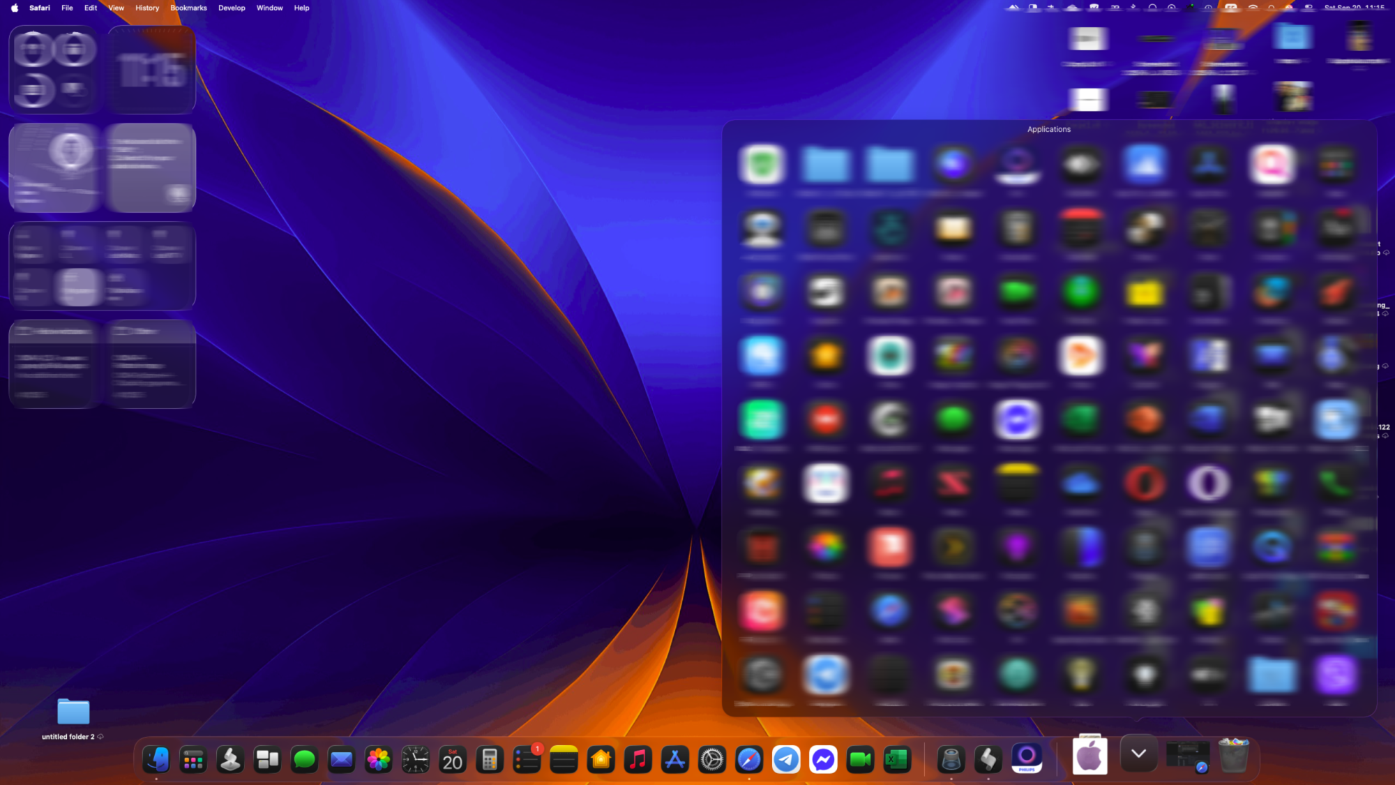

It works like this, but my goal is not to open a folder with Finder, but like the "Downloads" folder opens when it pops up from the dock. This is how I want it. But apparently there's no way.
