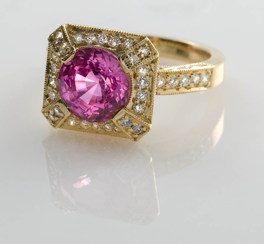

As a little disclaimer to what I did above, this technique only works for box like objects. Things like spheres, rings or anything with objects protruding on the front will not look natural. Like the ring image attached. The reflection would show what is underneath.
