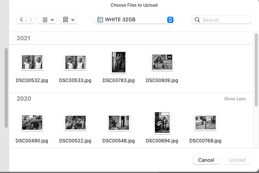

When using Finder directly all is good, but then when I am on a forum, on Facebook, or anywhere else when I want to add a photo to a post a Finder window pops up with the original tiny thumbnails. 🙁 How can I make this pop up Finder show the default thumbnail size that I set?
Here is a screenshot of what I see when I try to add a photo to a forum, Facebook, etc. post:

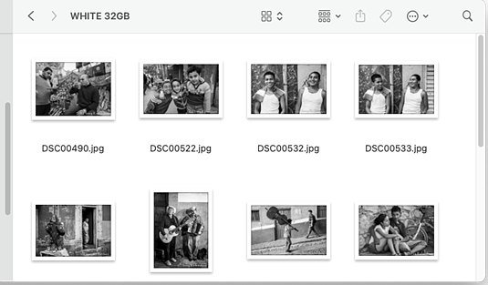

Here is a screenshot of Finder with the new default thumbnail size:
9ccc397f595f455db9bb9728080943ce
Any ideas on how I can get the thumbnail size to be larger in the Finder window that pops up when I want to add a photo?
I would try changing the View style in the "Choose Files to Upload" dialog window. There are controls to the left of the hierarchical popup (shows "WHITE 32GB" in screenshot), so look there for available options.
For example, I gave up on Icon view years and years ago. Instead, I use the Columns view with the Preview pane visible on the right. This lets me navigate with the arrow keys, and if it's an image file selected, it shows up at a decent size, certainly bigger than in Icon view. For me, this is better than Icon view, not least because the image files don't need thumbnails.

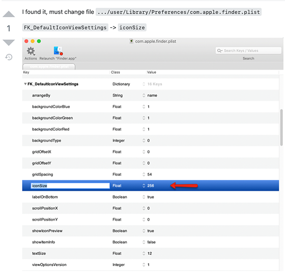

I have been searching trying to find the answer. This is what I found:
84a48e2d6fe049c3b037aab910be2717
https://superuser.com/questions/140...ons-thumbnails-when-opening-files-to-upload-i
I found the com.apple.finder.plist file. What kind of file is it? How do I edit it? I tried TextEdit, but it just displayed a mess.
I searched on the internet and found that I should download Xcode which includes the Property List Editor:
https://apple.stackexchange.com/questions/5278/how-do-i-edit-a-plist-file
Well, I am not going to do any of this. This is braindead.
