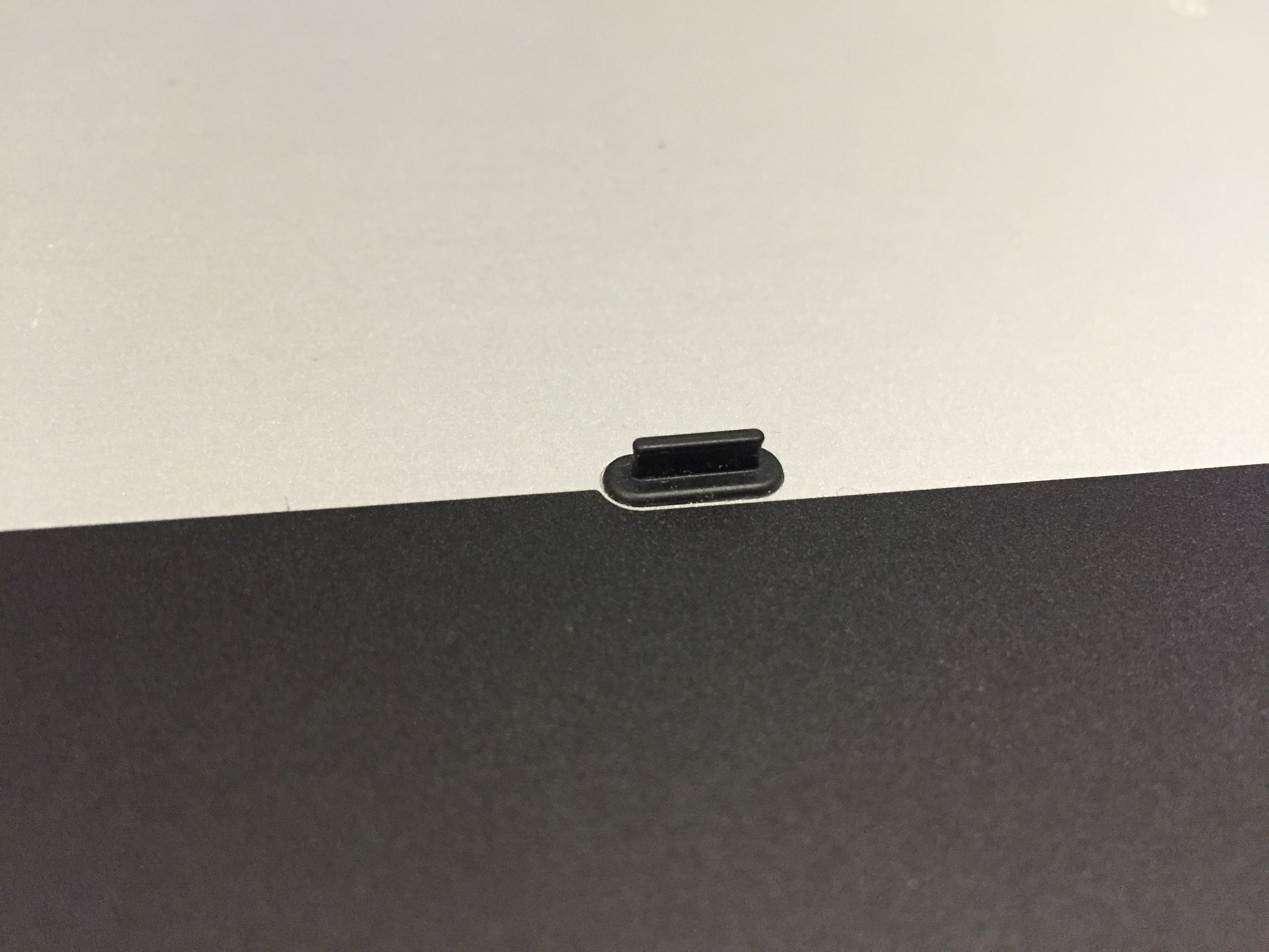

I think the real cause is just as this guy found (old thread on the apple discussion boards):
https://discussions.apple.com/thread/4108642?start=90&tstart=0
After I took those out, it is absolutely silent. No creaking when opening the lid, when moving it on my lap, when moving it from my desk to my bed. I always thought it was the lower case aluminum that was getting bent and causing the squeak; it's actually just those two annoying little plastic tabs that really don't seem to do a whole lot down there!
(They receive the aluminum tabs on the inside of the lower case plate, but it seems they aren't all that necessary.)

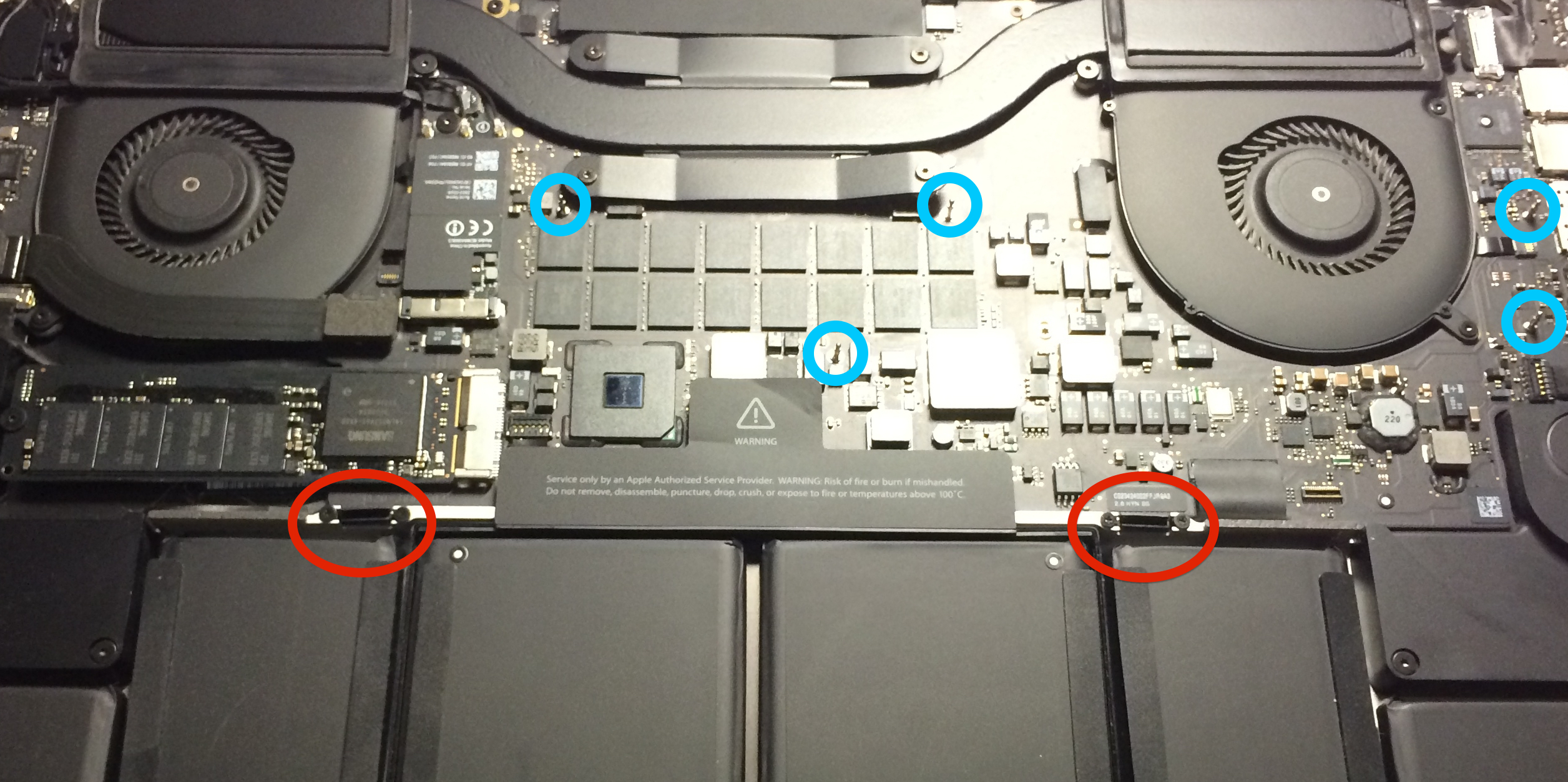

Ah I see what your talking about now, yeah those plastic bits are I believefor helping hold the bottom panel in place. On the discrete MBP's there were metal pieces that would clip into those parts. The spring loaded grounding pins I'm talking about are all over the board (highlighted in blue).
Edit: Popped open my rMBP 15" and those pieces in red are indeed meant to help attach the bottom panel to the top case. There are small black metal pieces that match up and clip into them on the back panel.
