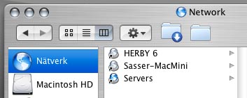

Can you not shut down your own network sharing on YOUR computer. Netsharing or file sharing on os x opens up too much resources. This why you are seeing computers from outside your WAN port if your isp does not restrict some ports or has built a local network in your building. It could also be wireless devices such as ipods and printers of your friends that pops up.
