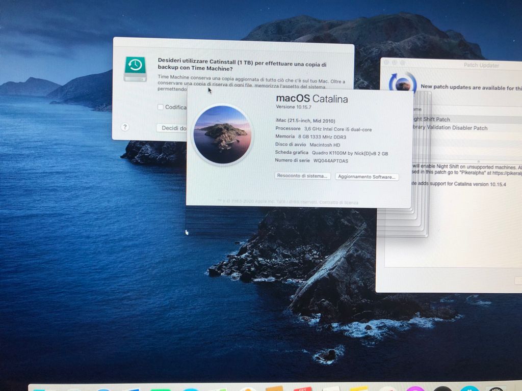

I succeeded in getting it working by installing OCLP directly to my internal drive.
Then I tried to upgrade to Catalina but I had issues with the graphics (very laggy and definitely unusable, picture attached).
In the end I needed to make a High Sierra install drive from another Mac, and after installing now it’s working properly.
Such a pity Catalina didn’t work: any ideas?
nVDIA acceleration is broken in Mojave and Catalina.
You can only go Big Sur.
