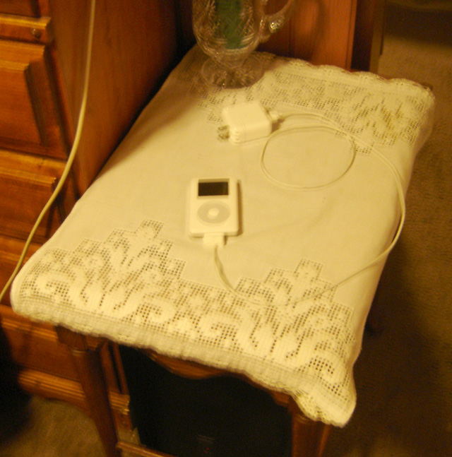

Step 1: Put it on top of your 230 watt subwoofer...
Step 2: 🙁

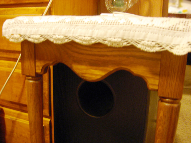

This isn't my iPod, but a family member's. I don't know who put it there, but its sorta my fault, since I tried to hide the sub under that little table and I didn't tell my family that:
Subwoofer= giant magnet = Electronics death
The iPod is now dead, with a sad faced icon 🙁
*Sigh*

Nope. The iPod is dead. I can't even reformat the thing, my Mac sees nothing, and its out of warranty.
RIP: 20GB 4G B/W HP iPod 🙁
Man, that sub screwed it up pretty bad too, instead of the commonly heard clicking, its a screetchy whining noise... Sounds like its in pain🙁
And to think, what if it was my PowerBook that ended up on that table? 😱

Also I doubt that the Sub's magnet "injured" the iPod. The vibration more likely.
Magnets don't injure electronics. A magnet "could" flip bits on the platters and screwup the format. But a sub or any speaker I know isn't strong enough to do that.

Is it the sound of the hard drives read head scraping the magnetic material off of the platters?
If anything, the vibration could have been the problem. Not the magnets.
Seeing as how the warranty is expired, and you really have nothing to lose, did you try taking it apart? I swear taking things apart and putting them back together again will do wonders. Sometimes.

Sorry, but this advice is incorrect. If you replace the hard drive then the iPod will function just as it originally did. The hard drive in the iPod has nothing to do with the interface between the iPod and the computer.
If you have a scratching/scraping noise from the iPod then chances are that you've had a head crash. This could either be caused by the sub-woofer magnets slightly deflecting the drive head. But more likely it has been the vibration from the sub-woofer that has caused a head crash.
Hard drive specifications define a maximum amplitude and frequency for environmental vibrations during drive operation. Placing an iPod that close to a sub-woofer probably exteeded the specifications.
BTW, sub-woofer placement is not that hard. The sounds emitted by a sub-woofer are not directional (unlike other speakers) so you don't need to place a sub in the middle of your main speakers. The sub-woofer just needs to be in the same volume of air as the listener... behind the couch, off in the corner of the room, anywhere it fits. (And away from any electronics you care about. 🙂 )

put the ipod in the freezer for a night then try formating it, i resurected a 4g 40GB ipod like that a while back.
