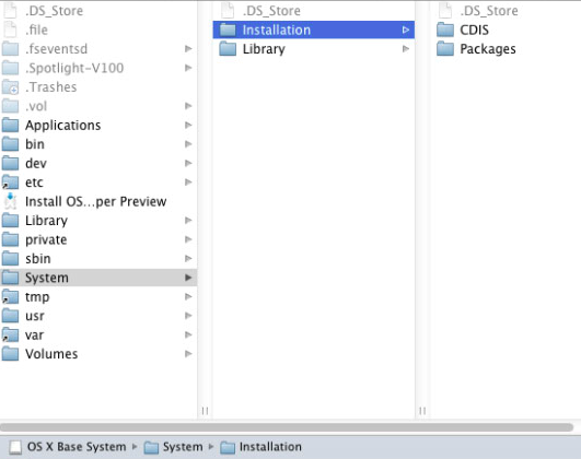

Show hidden files, and Go to your flash drive and look at System/Installation/ in Finder, and take a screenshot of the Finder window and post it here.
I deleted the Package alias and copied over the actual Package folder that was around 4.5GB. I just reformatted the USB drive because i was just going to go ahead and install mountain lion on the Mac instead.
Now, I was updating from 10.7 to 10.9 do you think that may have anything to do with it?
I'll post the screenshot shortly to see if maybe I missed anything
Here's a screenshot of the Flash drive and files. It's actually an older 20GB hard drive which I'm using.
