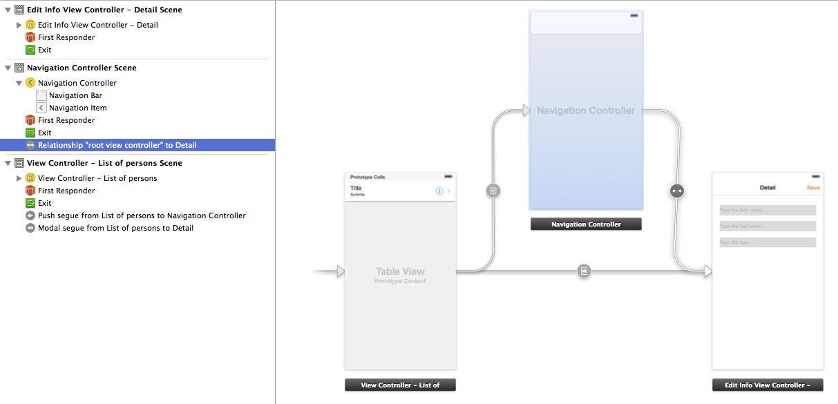

Probably a really newbie question but I can't seem to get it to work.
I want to change the startpage when the app opens. Currently it opens at Table View, but I would like to have it started at "Edit info View Controller".
I tried several things, but in all variations I got errors.
Screenshot of current setup attached.
Any help really appreciated.
I would delete the navigation controller and then embed the "Edit View Controller" in a new navigation controller. Then create a new segue to the table view
Hello AxoNeuron, thx for answering, as per your suggestion I've deleted the navigation controller, and embedded the "Edit info View Controller in a new navigation controller using "Editor" menu, "embed in Navigation Controller". I then created a modal segue from View controller to edit view controller and vice versa. But both didn't work. One crashed and the other one still starts at the View controller.
Also change relationship "Root view controller to Detail didn't work.
I've never seen a segue from a view controller to a navigation controller before. Try getting rid of it. Instead of segueing BACK to the other view controller, use the method dismissViewControllerAnimated and do that in a delegate method inside of the primary view controller.
On the far left on the table view, that little arrow indicates which view controller the application starts on. Try moving that to the other controller.

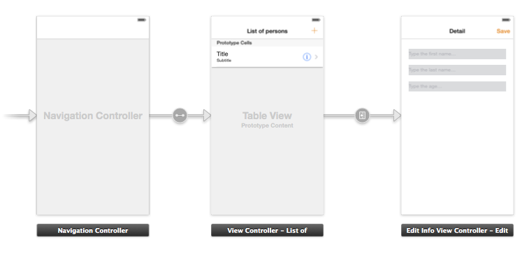

Ok, I've managed to make a small step forward; the arrow points to the VC that should be activated on startup. Unfortunately I now have the error: unsupported configuration scene is unreachable due to lack of entry points and does not have an identifier for runtime access via -instantiateViewControllerWithIdentifier.
Try using a modal segue perhaps from the table view controller to the secondary view controller? Is anything in your "Edit Info" view controller dependent on information coming from the table view controller?
As it stands, does the actual segue itself work?
A modal segue didn't work for changing the startup page.
Everything else works as it should.
The initial goal was to make a startpage that contains a text input field, and when clicking save the name (text input) was stored in the SQLite database, ready to be exported as a text file when finished adding data. Basically I only need 1 page. I couldn't make this work, so a lot of research brought me to the following alternative. Maybe I started completely wrong and making this too complicated.
I am not sure if I understood correctly but:
  1. - Delete all your segues, including the one from the UINavigationController to your UITableViewController
  2. - You will now have three independent controllers floating. Rearrange your controllers to the desired order
  3. - Drag a segue from your UINavigationController to your EditViewController. Select root view controller from the drop down menu
  4. - Drag a segue from your EditViewController to your UITableViewController
Follow the rest of the instructions 😉
The title appeared again 🙂
Unfortunately I have two errors now:
Unsupported configuration: Segues initiated directly from view controllers must have an identifier for use with -[UIViewController performSegueWithIdentifier:sender]
I gave the controllers both a StoryBoardID but that didn't seem to help.
Any suggestions?
Any suggestions?
The segue from your EditViewController to your UITableViewController needs an identifier. Select it and give it one.
Also note that you are going to have to update your code with the new identifier and perhaps update your app's logic as well since you have changed the way it works.
Forget the storyboard id, there is no need for it
The errors are gone, but the application crashes: libc++abi.dylib: terminating with uncaught exception of type NSException.

Oh, as I said earlier, you have to change your app's logic.
From your crash log, because the EditViewController used to come after your UITableViewController, EditViewController expects to be "fed" by an object from your UITableViewController. As it is now coming before the UITableViewController, the method "loadInfoToEdit" in EditViewController has nothing to load and therefore crashes.
Not sure how to do this; information that I found related to xcode 4. Is it remove Bundle Loader and Test Host or does it refer to Choose File > New > New Target and selecting Cocoa Touch Unit testing bundle from the menu?
It seems to me that something in the Edit Info view controller is dependent on information coming from the table view controller. It looks like it's trying to access an object from an empty array, causing the crash.
I'm just a beginner, just started learning about table views and delegates last week so that's all I can really say. I'd be interested in hearing the thoughts of others about this problem.
No, I meant change the actual code. The app was programmed to have the EditViewController populated by the UITableViewController.
You have modified the storyboard to show the EditViewController before the UITableViewController, now you have to modify the actual code to support the changes you have made.
I suggest taking a few steps back and start learning programming from the very beginning, before diving into more complex stuff
I could be mistaken but if I understand your goal there is nothing wrong with your initial setup. If you aim to
1 have a tableview containing names and
2 selecting a name segue ways into your edit page and
3 you want to add names and its data
You should just ctrl-drag from the orange + to the EditViewController [with an appropriate identifier etc]. As to starting with the EditViewController: why not add a method in viewDidLoad seguewaying to the EditViewController [with indexPath.row = count of your NSArray of names +1]?
Wow, I have never taken the time to learn storyboard properly and I am glad I have never.
I assume the edit menu is editing the content of your table view.
If it were me i would not use a storyboards and set the RootViewController in applicationDidFinishWithOptions in your AppDelegate to the UITableViewController.
On viewWillAppear for the UITableView present the edit controller modally.
Then when you dismiss the model edit view, you will be back in your tableView. 🙂 Which is where I assume the user will spend 90% of their time.
