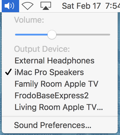

You don't have this options when you click the speaker icon on the menu bar?
is that from your mac pro? The imacs have slightly different ports.
Yes, that's from my Mac Pro. I didn't deal with iMac for quite a few years already. But the OS itself should be the same. There is no such audio options for you? Or it's there but doesn't work?

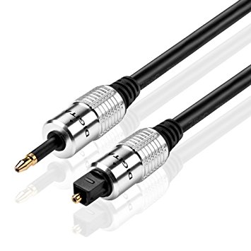

imacs of this vintage have a combination jack-- plug in a 1/8 stereo miniplug and it acts as a headphone jack; plug in a minitoslink cable, and it acts as a optical output. In either case, it shuts off the speakers.

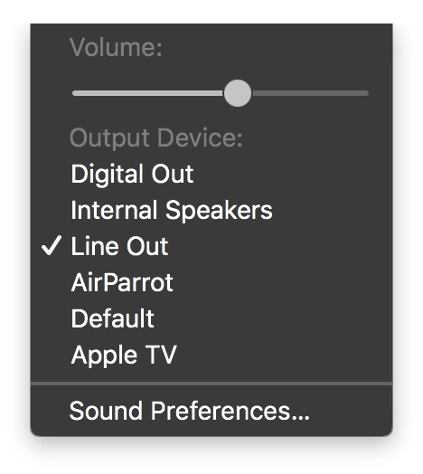

No! How the heck did you get THAT menu? I only get a greyed out speaker icon and the only two options listed are "digital out" and "apple TV front" (which is my appletv in the other room that has the TV). No "internal speakers", which is EXACTLY what i want to be able to choose!

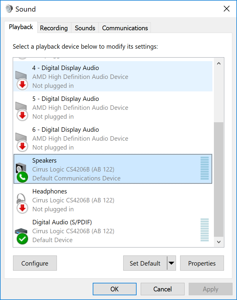

"Proof" that it is technically possible to use both the optical out and the speakers, given the appropriate software and drivers.
and yes, I have tested this.
The Bootcamp experience is kludgy and delicate, though.

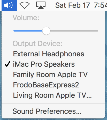

Here I have headphones plugged in but sound from speakers.
Ok HOW are you seeing that? I don’t have that. Maybe you have a newer iMac that LACKS the optical out inside the jack? And to the USB DAC option: I don’t really want to convert to analog before my amp. It has a decent DAC and optical input. I’d probably need a USB-to-optical if that exists. Or: Apple could make the OS more flexible with what i’m Trying to do.
It's just the Volume menu from the menu bar. If you plug in headphones what do you see?
Edit: Hmm, I just checked my 2014 iMac and it doesn't have the same option, so I guess you're right about newer iMac.
Is the iMac Pro "newer" than your imac?
Yes, my iMac is from 2013. And strangely, Apple *removed* the optical portion of the audio output on *newer* iMacs (current ones). So I wouldn't have this "problem" if and when i upgrade to a new iMac, but then i also won't have a digital audio out that i can use to move audio digitally to my receiver. Progress!

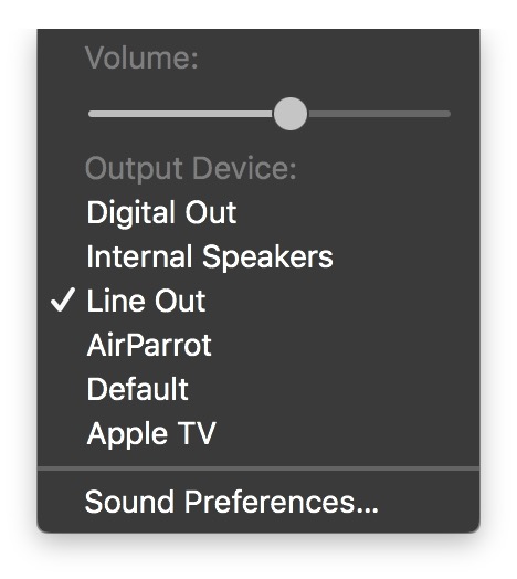

So... I see there're differences depending on model. Yes, but every mac I've met has something that looks hardware related: when you plug a jack in "audio-out", sound is routed out; internal speakers & line-out are considered as one, as @Fishrrman points.
I can (and you could) choose sound way-out because I've implemented a second device through USB (a DAC, but a simple USB-line-out should work. Do you remember Griffin's iMic? It was used 'cause we hadn't line-in in older macs; we're again in same situation: 2017 iMacs have only line-out. In iMacPro combined line-in-out is preserved, +optical out).
BUT, a lot in software side can be done. Just check how you can still choose to drive system's sounds to internal speakers in Preferences. Sound produced by apps will go to line-out (& external speakers or earphones). So... it should be possible to choose easily between internal/external speakers!
