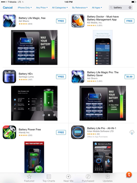

There are quite a few battery apps in the App Store. One of them might work for you.
