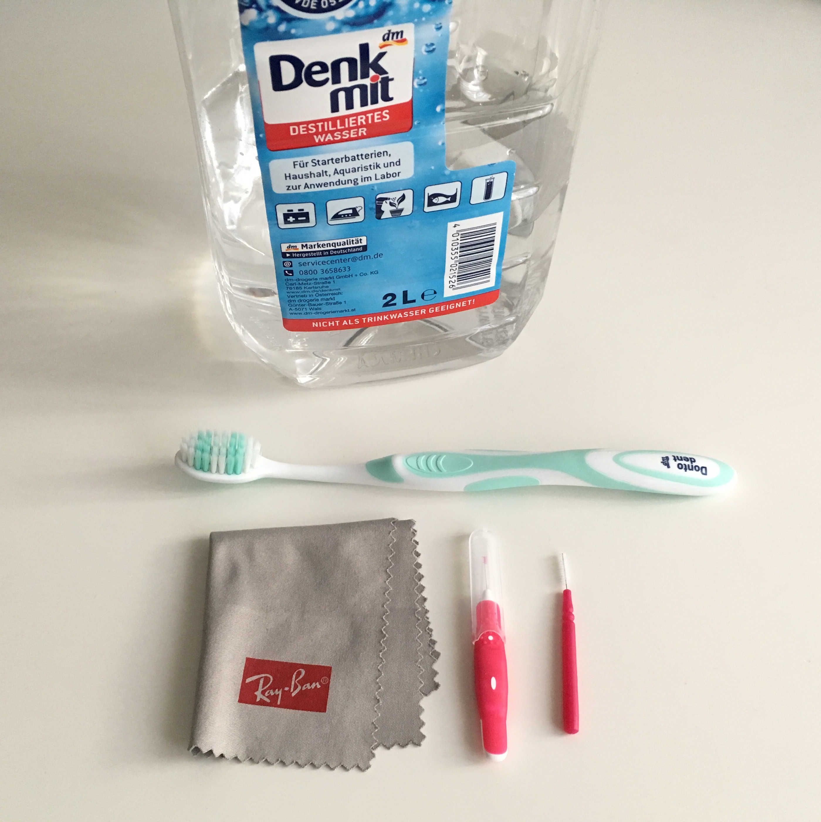

Earpiece grill speaker:
sensitive tooth brush eg Dontodent Handzahnbürste Super Soft, sensitive dauerhaft günstig online kaufen | dm.de
and very small amount of distilled water

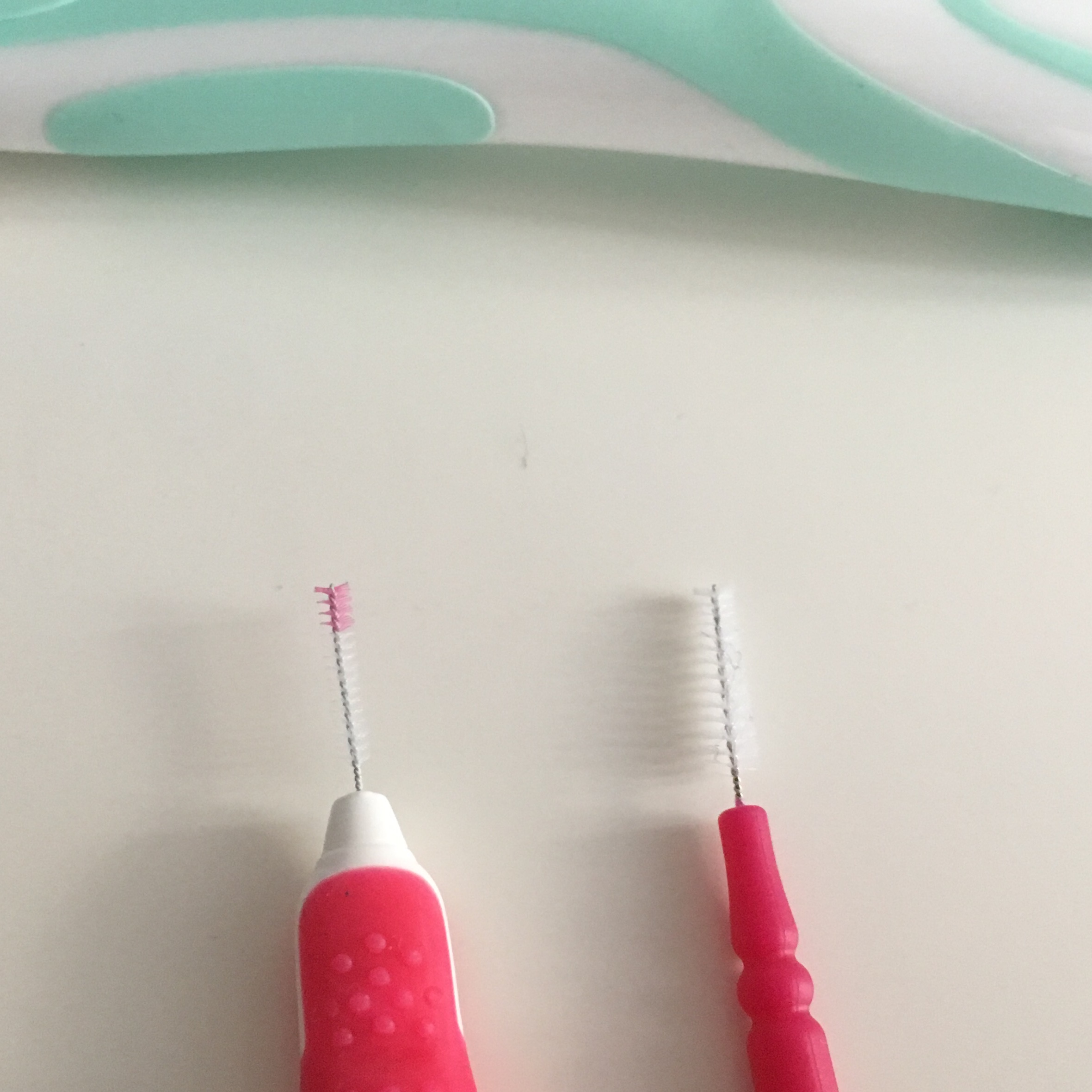

Headphone jack:
interdental brush #1 eg Dontodent Interdentalbürstchen Rosa 0,4 mm ISO 2 dauerhaft günstig online kaufen | dm.de
Lightning port:
interdental brush #2, careful don‘t brush the contacts at the bottom side eg Dontodent Interdentalbürsten Pink 0,4 mm ISO 0 dauerhaft günstig online kaufen | dm.de
Looks like new after, be careful with pressure
sry for the german links but I hope you get the idea
