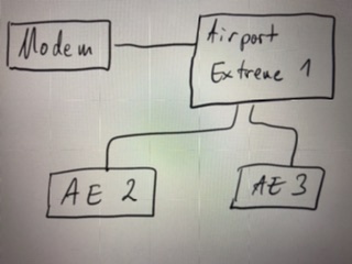

Looking for help, and sorry if this has already been answered but I couldn‘t find it, so here is my challenge:
I have two ethernet-wired Airport Extremes in my roaming network. To cover also the garden, I would like to add a third one, preferably also by ethernet.
As far as I understand, this would be the recommended way to do it:

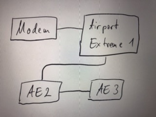

Unfortunately, I do not have enough ethernet connections to do this. What I could do is:
Would this also work?
Yeah, that ought to work (I haven't tried it). BUT, just FYI: I got an eero setup a few months ago, and it's great! Very easy to set up, works like a charm, and not too expensive. I have the eero 3, I understand the eero 6, which came out recently, is even better.

Hi everyone,
Either will work.
I used to run 3 quite some time ago as well. Just run the additional AEBS in bridged mode and not router mode.
