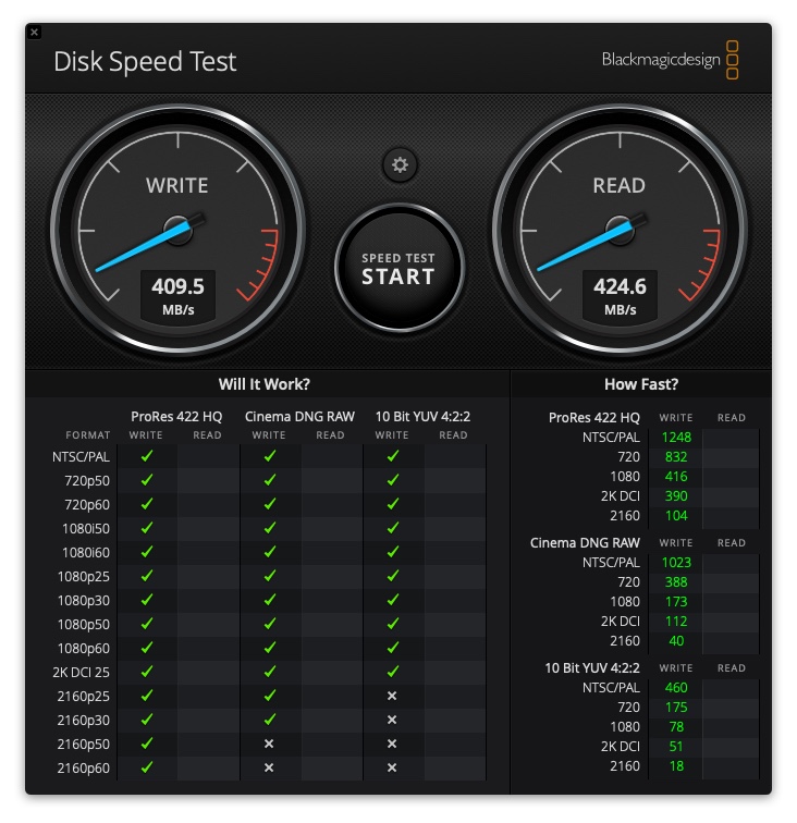

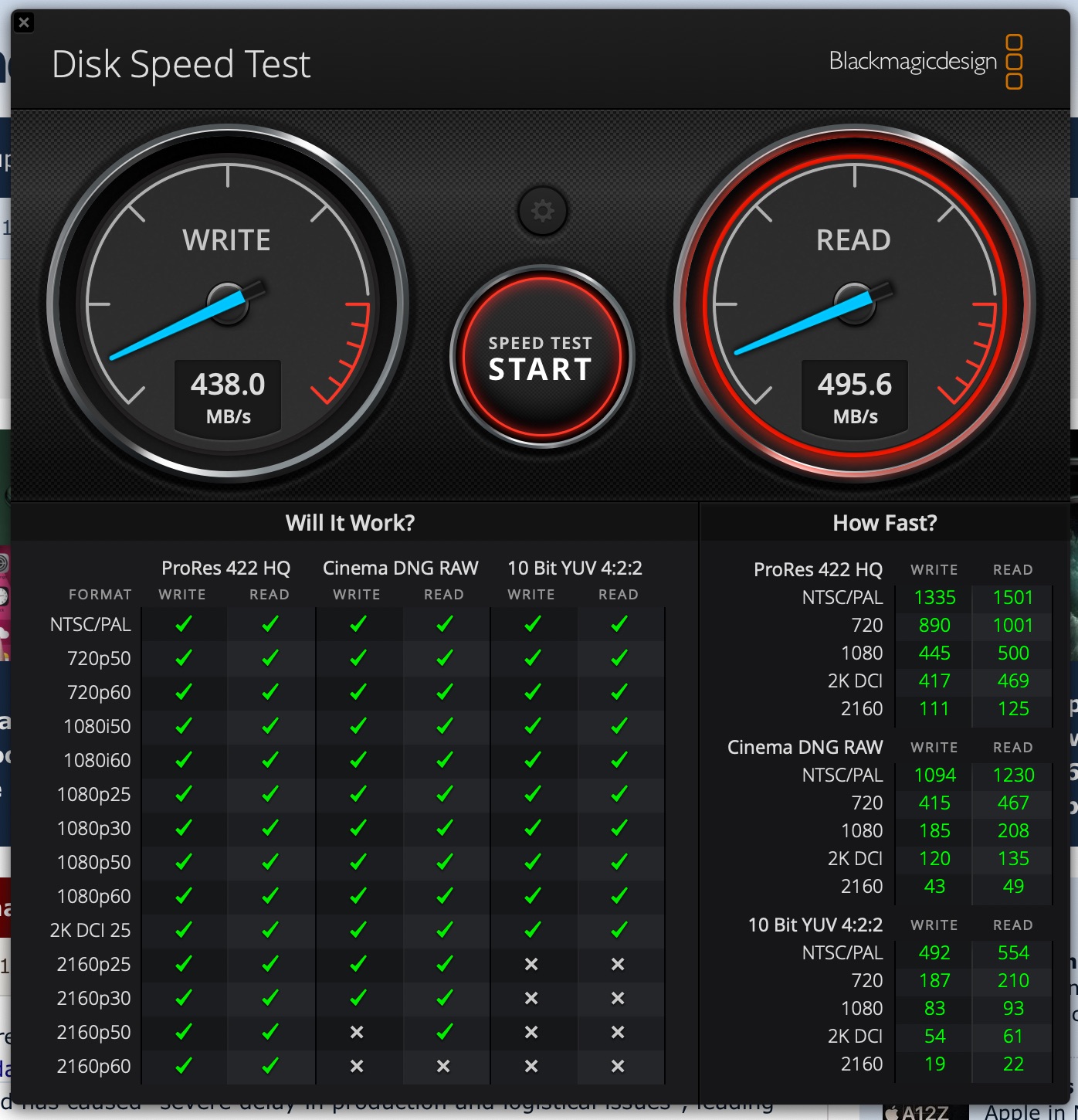

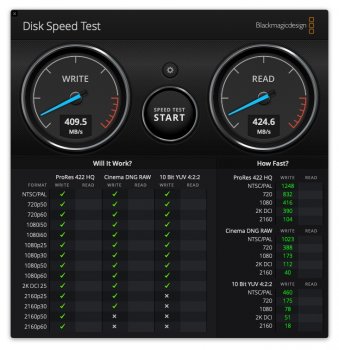

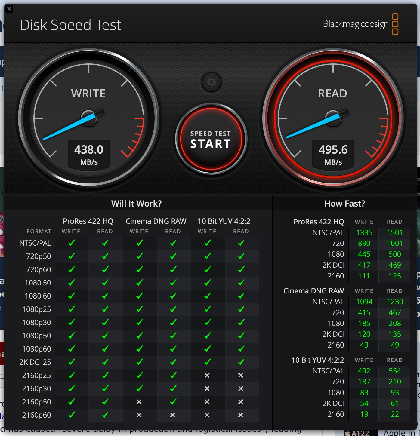

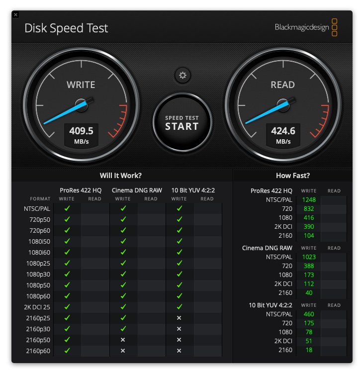

Well stone me. Much better results using BlackMagic :
Caddy > MacMini with USB3
MacBook Pro > Caddy. USB-C
