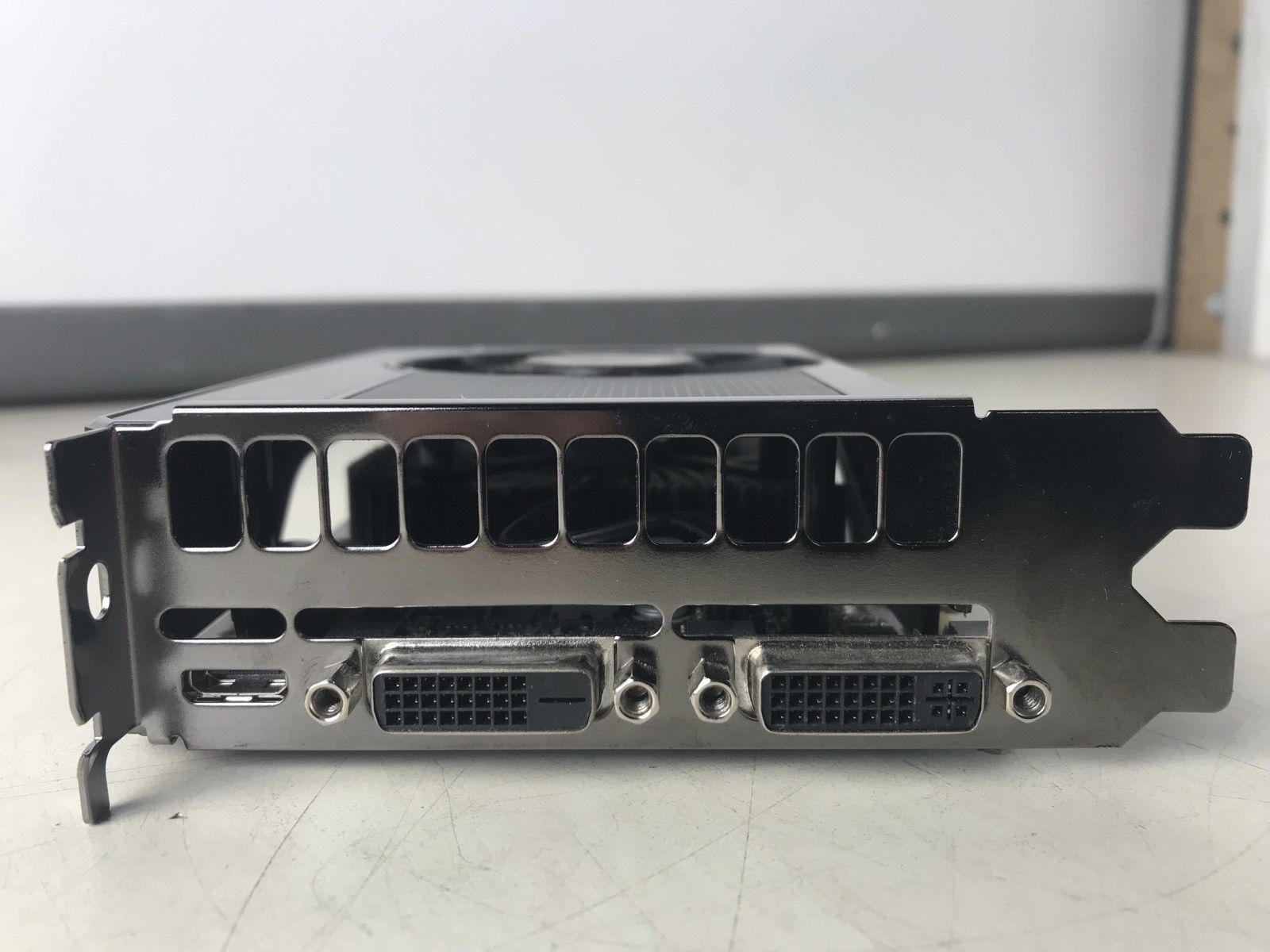

Does your card put out dual-link DVI? Single-link will not be enough to get 2560x1440.

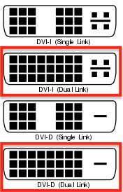

You can visually inspect the card and see that straight from the connector (you need either the DVI-I Dual Link or DVI-D Dual Link), pic attached.
If it's either one of those, it might work, but you will need an active adapter at least. They are expensive, and that's why you might want to upgrade your graphics card instead. It's gonna be of more help and probably faster too.

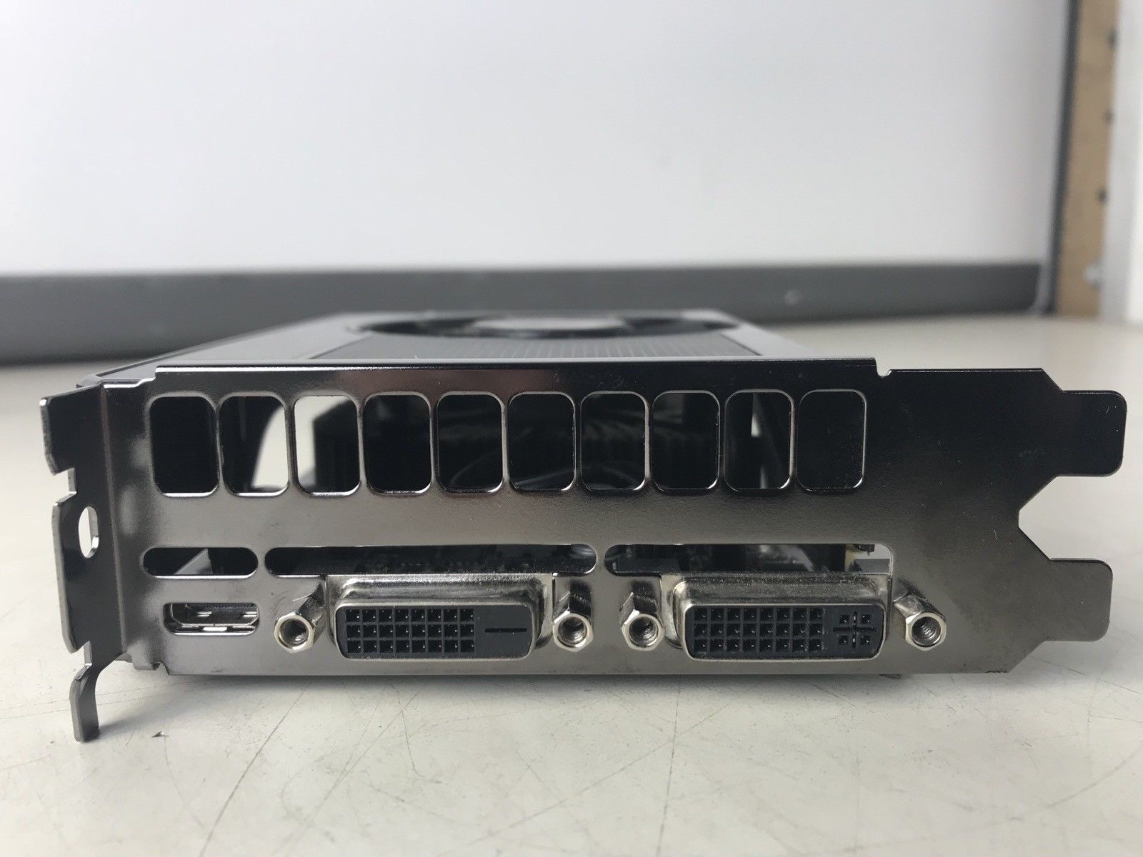

It's Dual link, with both of those. Here's a pic below. From what I've learned is that the above *may* work but it won't go above 1920x1080.

According to these specs:
https://www.geforce.com/hardware/desktop-gpus/geforce-gtx-650ti/specifications
Your GPU has: One Dual Link DVI-I, One Dual Link DVI-D, One Mini HDMI
Only way to drive 2560x1400 with that GPU is via Dual Link DVI-D connection. DisplayPort and miniDisplayPort are easily interchangeable with adapters. Personally would just look for another GPU with mini DisplayPort onboard to make your life easier.
