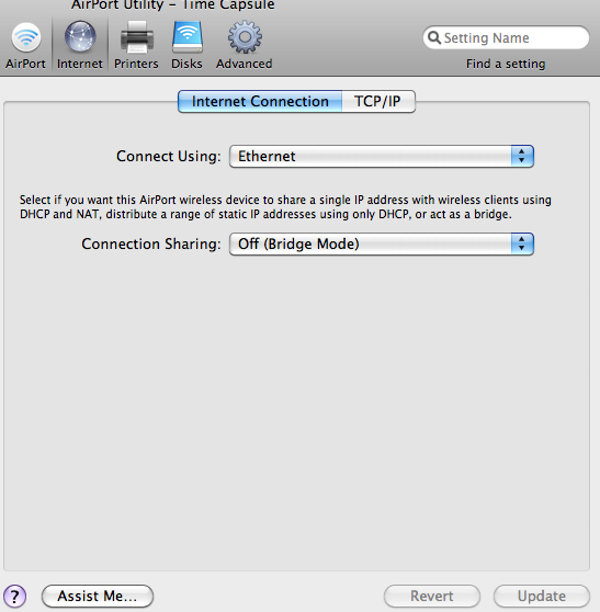

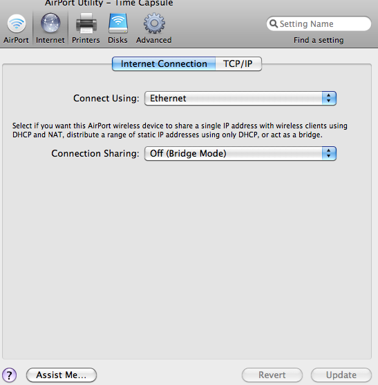

Then you want to plug the AE into the network via ethernet. Then, in Airport for the AE, you need to click on the Internet tab and switch the Connection Sharing option to Off (Bridge Mode). This will turn off DHCP on the AE, and the UVerse router will still be the one distributing IP addresses.
You can still setup a new Wireless network on the AE, which will be a separate network from the wireless UVerse network.
