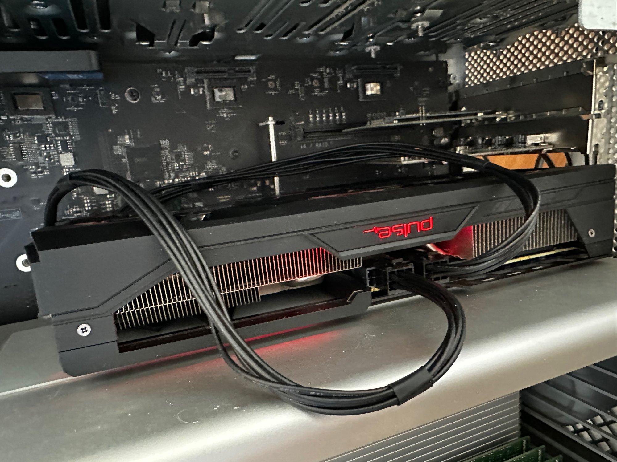

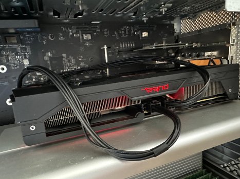

So i got the Vega 56 today, Sapphire version.
I got tons of issues !
1/ The little switch on the card does not indicate anything, it's just left or right.
2/ I didn't get the EVGA Powerlink today, so i just tried to connect the GPU with the cables.
The fans won't start on the GPU, and i have no display.
Could it because i don't use the EVGA Powerlink ? Or is it because of 6 pins to mini 6 pins ? The GPU has 8 pins.
3/ I don't think the EVGA will fit in the card, my PCI port are ... In the middle of the GPU. I don't think it will fit in.
Too bad 🙁
Move the switch in the direction of the video ports for Quiet (low power) mode:
Yes. You're only connecting 6 of the 8 pins on each power socket - it's not surprising the graphics card isn't working properly. You need mini-6-pin to 8-pin cables (or use the PowerLink etc.).
Too bad 🙁
It's not an especially elegant solution, but you could mount the PowerLink somewhere convenient, then run cables from it to the GPU.
