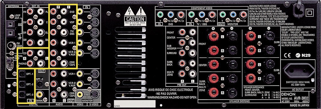

I'm slightly confused. I know I should be able to get airplay by purchasing the airport express stereo connection kit and then connecting my AE to my Denon receiver AVR 3802. Where I'm losing it is where on the Denon do I connect the cables to play off my speakers?
You have two options:
1) Use a mini toslink to toslink optical cable to connect to one of the optical ins on the Denon (OPT.-1, OPT.-2 or OPT.-3). Optical (Digital) will give you the best possible audio.
2) Use a 3.5mm minijack to RCA connector to connect to one of the RCA ins on the Denon (DVD, VDP, TV/DBS, VCR-1, VCR-2/V.AUX, CDR/TAPE, CD, or PHONO).
Wow! Thanks Swede! The diagram is sweet. So can I use the Apple Stereo Connection Kit on one of the options?
Yes, Option 2. However, it's an overpriced 3.5mm to RCA adapter. Just buy the one from monoprice.com for $0.65 and save yourself $38. You will notice absolutely no difference.
Or better yet, get the mini toslink to toslink optical cable for $2.41 and get great sound.
Monoprice's shipping is cheap and fast and their cables are excellent quality. You just don't get any fancy packaging as they come in a plastic bag.
