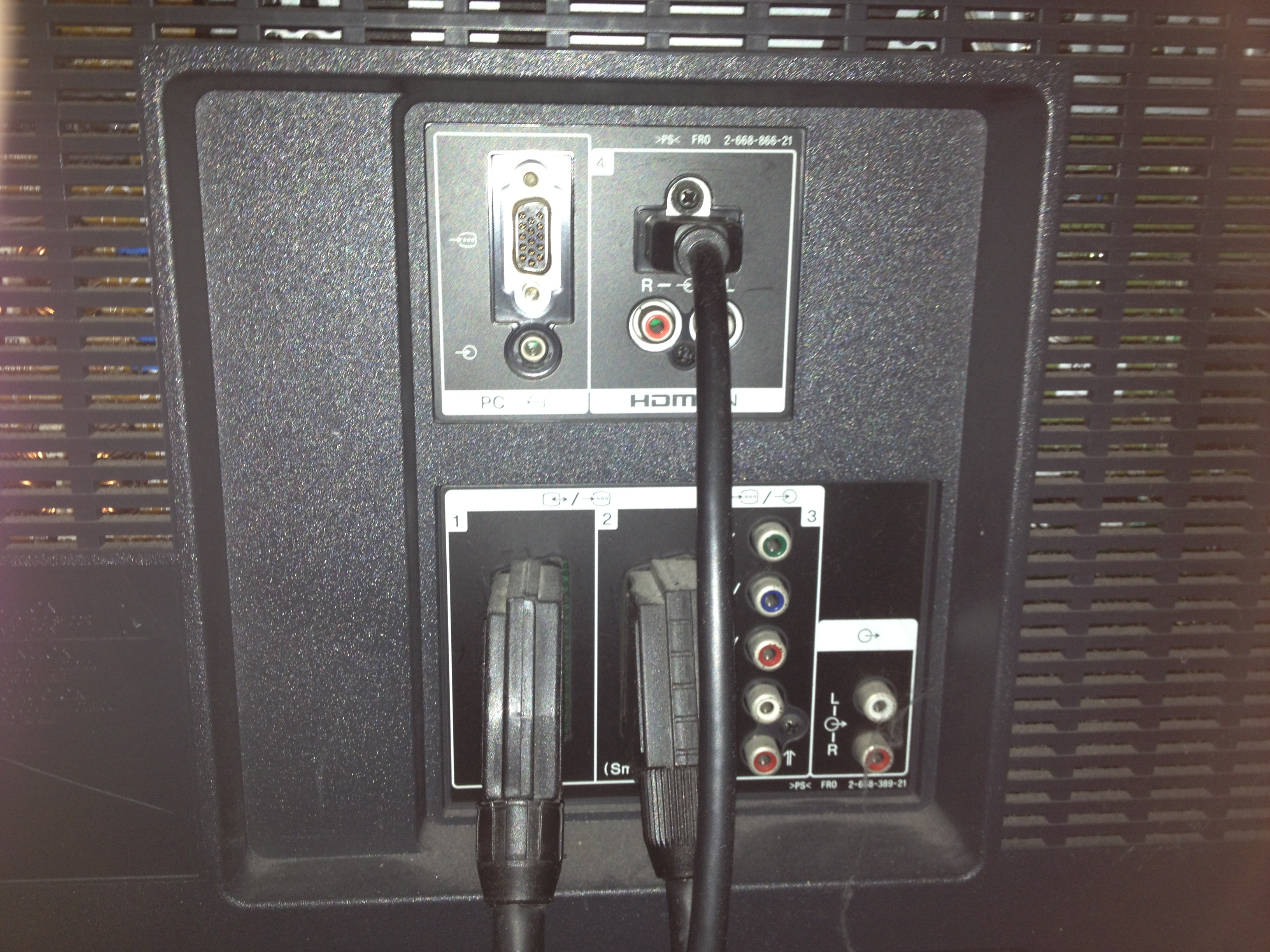

This is my TV, as you can see I don't have a HDMI slot free. Can I still connect it?

I'm located in the UK. Can I just buy a HDMI splitter?
Maybe, you want an HDMI splitter that has 2 inputs and one output. Most are the opposite. You do not want to buy something with 2 outputs and one input. That will not work for you.
Edit: As jeremiah stated you want to look for a "HDMI Switch" rather than a "splitter" from what I have seen.

Looks like you have a VGA input on that TV -- similar to mine. As long as your TV supports 720p or 1080p, you can try the Kanex ATV Pro:
http://www.kanexlive.com/atvpro
I just picked this up yesterday and had my ATV3 up and running within minutes. I love it.
