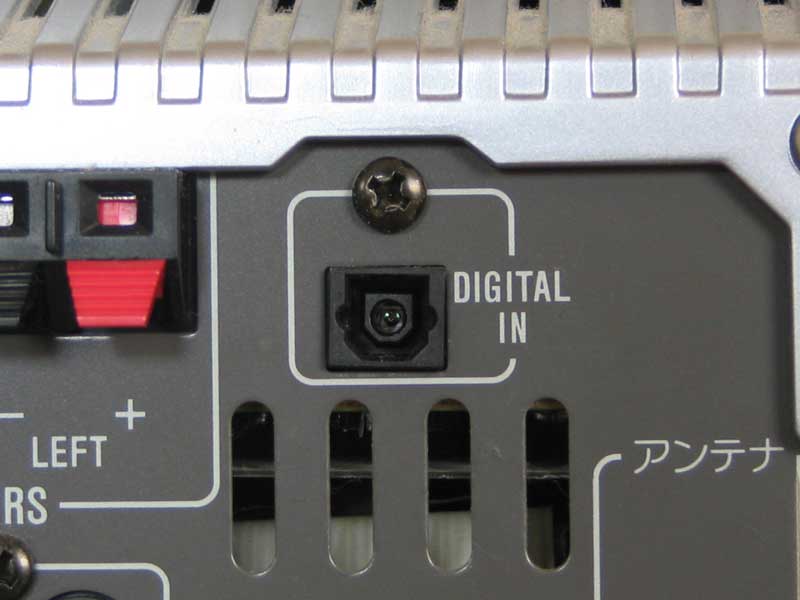

You should either use a 3.5mm to RCA cable or if the amp has a digital (optical) input *, you could use a TOSLINK cable.
also called SPDIF
Optical is best if possible.
