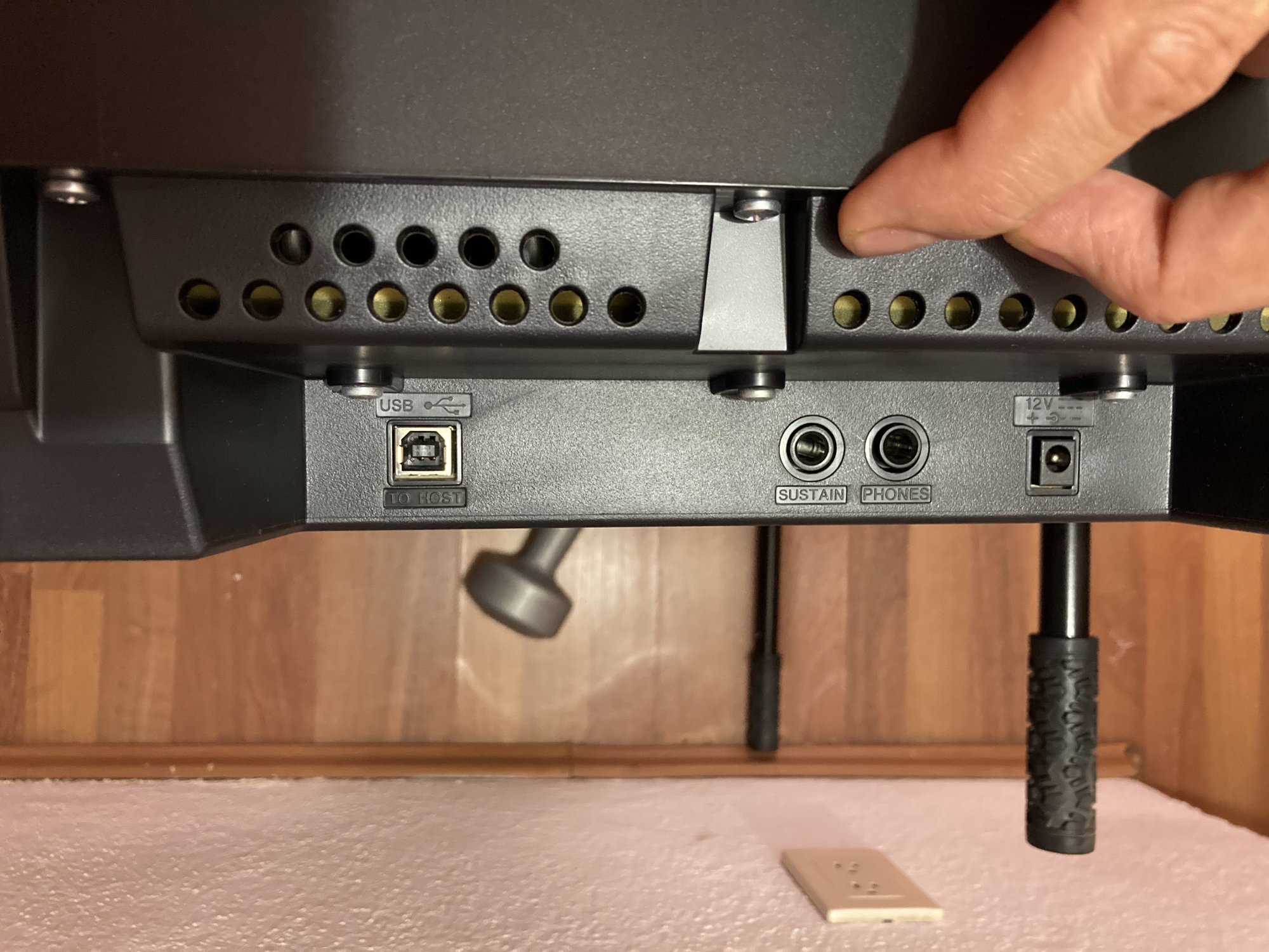

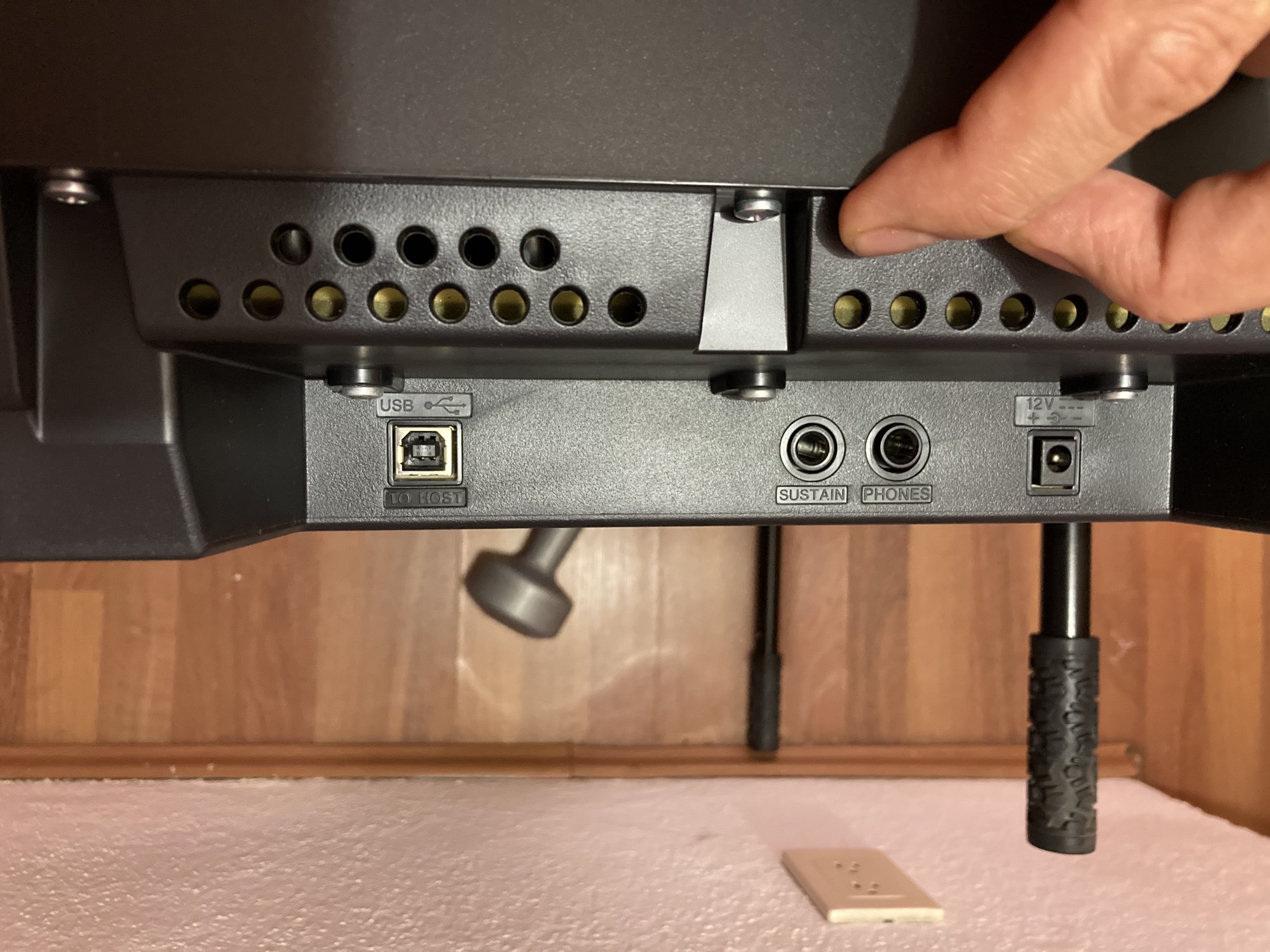

I'm guessing you have an iPhone, if so, you'll need this kind of cable, connect the midi out [USB] from the piano (if there is only one USB plug, it usually is a midi out one) into the smarthphone and maybe select the input in the specific app you're using.

Thank you for help and even making a photo to illustrate! My digital piano only has a round audio jack for headphones. I'll need another piano with MIDI out, apparently.
