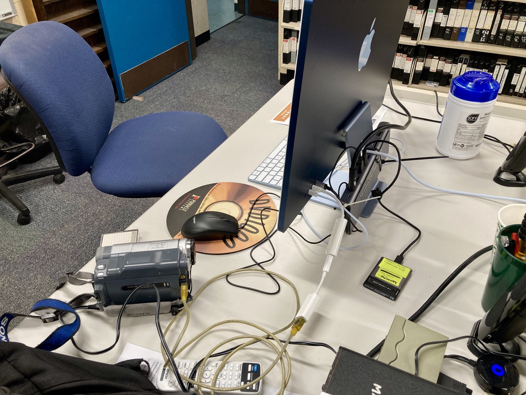

First, you'd need to find an Apple FireWire to Thunderbolt adapter. Apple recently discontinued it because it uses the older Thunderbolt 1/2 protocol, but you can likely still find them on eBay or something. Then you'd need Apple's Thunderbolt 2-to-3 adapter to daisy-chain it to (and it does work!) Then hook a DV FireWire 4-pin to 9-pin cable between the camcorder's DV port and the FireWire to Thunderbolt daisy-chain plugged into your Mac, and you should be good to go!
This is what I am currently doing for my college's TV studio, digitizing their old Video8 and Hi-8 tape library via a Sony Digital8 camcorder that supports playing back analog Video8/Hi-8 footage, hooked up to one of their M3 iMacs.

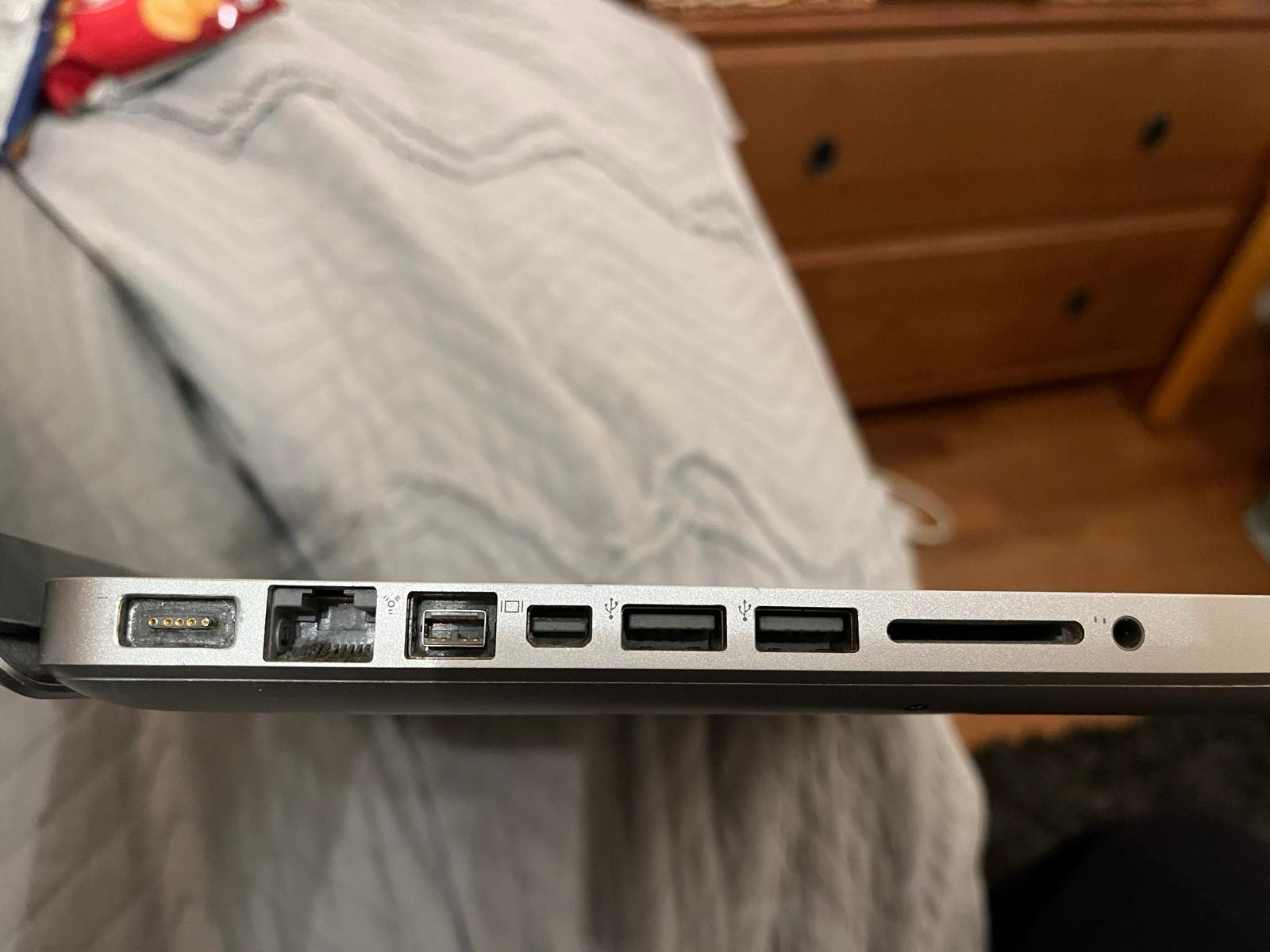

So something like this...
Yes. That looks just like the cable I used many years ago to import my DV footage to a 2008 iMac. It should work with any Mac that has a Firewire 800 port like the MBP Mid 2010 you showed in the photo.

Yep, that should work fine! I've used similar for years, and even using the "adapter chain" dandeco mentions to a modern Apple Silicon Mac.
Yep. In addition to doing so with the M3 iMacs at my college, I've also done this with my M1 MacBook Air.
