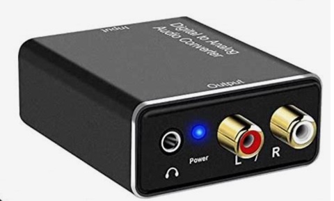

Option 3: if the TV has any kind of audio out, you might find you can get a box to receive audio out from TV and give you a headphone jack. This would be similar to the Audio Extractor just referenced, probably working with the TV's optical out or even RCA jacks. Like this...
Toslink Optical plugs in on the other end (input) and headphone jack plugs into the visible port. Odds are high that this would deliver stereo audio at best.
