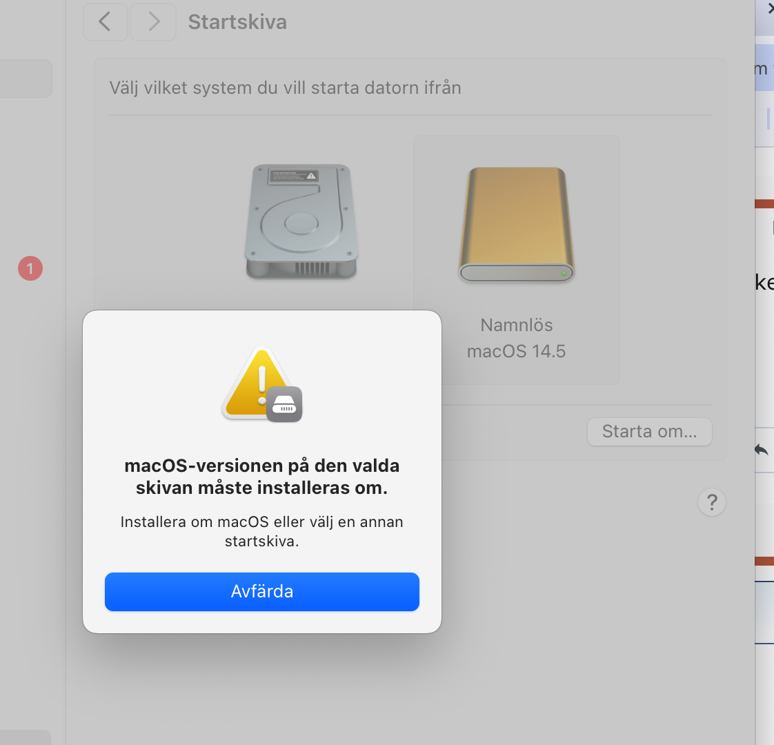

When choosing to boot from the external SSD in MacOS settings it says "The macOS version on the selected disc must be reinstalled." Just normally hold the power button and choose to boot from the external SSD dont work either. 🙁

This is the error i get when trying to boot from MacOS Sonoma installed on a external SSD.
""The macOS version on the selected disc must be reinstalled."

First:
Use an external SSD (NOT a platter-based hard drive) for this job.
HDD's simply aren't fast enough any more.
The SSD should not be used for anything else EXCEPT the bootable drive (i.e., don't "share it" with a tm backup, etc.).
Re the reported problems with the Samsung t7 and t7 "Shield"...
I've seen some eccentricities with the t7 drives -- specifically, write speeds can be dead slow (like 2-4MBps) when running speed tests on them. These can be remedied, at least for backup and data drives, but might affect how a drive runs at boot.
For an SSD that seems to work fine as an external boot drive, I've been using a Crucial x9 (1tb).
Or, get an nvme "blade" SSD and the USB3.1 gen2 enclosure of your choice, and make your own.
OK, having said that...
If you're using an m-series Mac, I suggest that you use the free utility called "Mist" to both download the OS installer AND create a bootable flashdrive, all in a single operation. Get Mist here:
(you want the "dmg" file)
Use a USB flashdrive 32gb or larger.
NOTHING smaller.
Erase the flashdrive to "Mac OS extended, journaling enabled, GUID partition format".
DO NOT erase the flashdrive to APFS.
Now open Mist, locate the OS version, and let it build the flashdrive installer.
Once the flashdrive is created, boot the m-series Mac from it.
If it opens to the installer, QUIT IT for now and open disk utility.
We need to prepare the SSD.
IMPORTANT: Go to the "view" menu (disk utility) and choose "show all devices".
Look at the list on the left.
Locate the SSD, and click on the top line (for the SSD) that represents the physical drive itself.
Erase to APFS, GUID partition format.
Quit disk utility and open the OS installer.
Start clicking through and when asked where you wish to install, select the external SSD.
Then let the installer do its job.
It will go through several reboots, and the screen will go dark for a minute or more with no other indication of activity. Just be patient, it takes a while.
When done, when you see the initial setup screen (choose your language), decide whether you're starting "completely fresh" or want to migrate from a backup.
If you're migrating, connect the backup NOW and go on.
Good luck.
