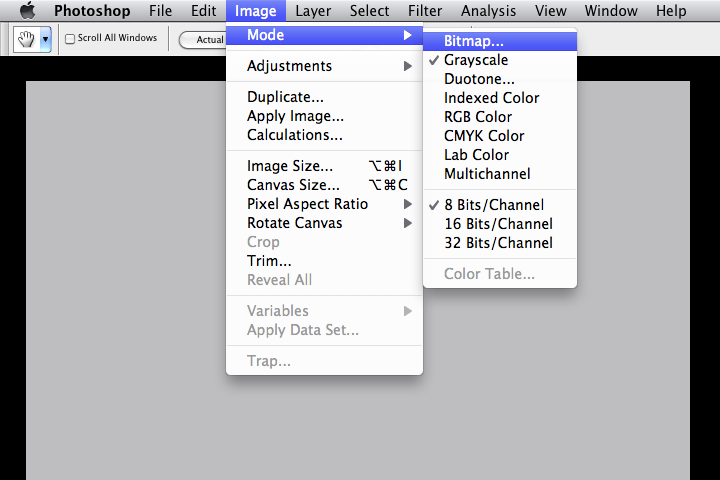

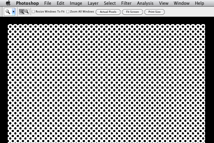

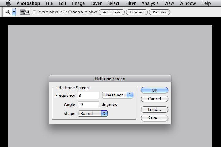

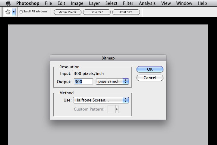

If I wanted to control (completely) the size of the dots and the space between them I would create a small area, then duplicate that layer, then Filter > Other > Offset the duplicated layer... and so on... and so on... until I had a page filled with small dots.
If it didn't matter (exactly) how big the dots were or how far apart they were spaced I would start with a grayscale file filled with a solid gray background (25% gray). Then I'd use the method illustrated below. You'll have to play with the numbers (and the level of gray you start with), but this will give you an idea...
