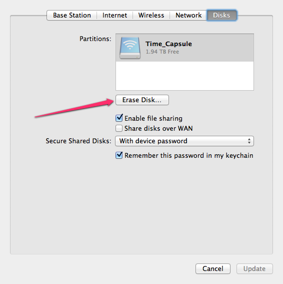

I am using a Time Capsule in bridge mode. I use it for my home network and as wired and wireless router and it works very well. I have a usb external disc attached to it. I also use my TC for Time Machine backups from three macs in my home.
I would like to delete the existing back up data and start fresh with a new time machine back up for each of my three computers. What do I need to do to delete the existing back up files?

Turn off Time Machine on all the computers. Then go to this screen in Airport Utility and click erase. Now turn Time Machine back on on each machine and select the Time Capsule as the backup destination. Done.

Cannot get the Airport Utilities screen you show with erase disc on it. It is a brand new Time Capsule, just arrived today.
Found screen, by hook or by crook.

Found screen eventually. But when I say erase, it says to choose from
Quick erase, non secure.
Zero out data
7 pass data
35 pass data.
On quick erase it says data stays there and can potentially be recovered.
The zero out says puts zeros over all data on the disc.
7/35 says writes data over the entire disc 7 or 35 times.
What I wanted was just to start from scratch with "as new" Time Capsule. This does not seem to do that.
Can you help me?
Use the quick erase. As you aren't selling it or getting rid of it, there's no point in zeroing out the data. Those options are for people that do not want others to be able to recover their data if they obtain the hard drive within the Time Capsule.
While quick erase doesn't get rid of the data on the hard drive, it deletes any references to it making the Time Capsule behave as though the drive was new or empty. As Time Machine needs the space, it will overwrite the existing data accordingly.
Quick erase and enabling Time Machine backups should start you fresh again.

You won't be able to erase a Time Capsule disk from Disk Utility. You will need to do that in Airport Utility from this screen (erase disk). That will not otherwise impact the Time Capsule or change any of the wifi settings.
